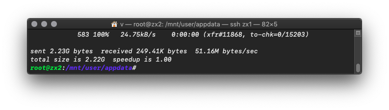

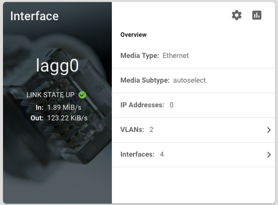

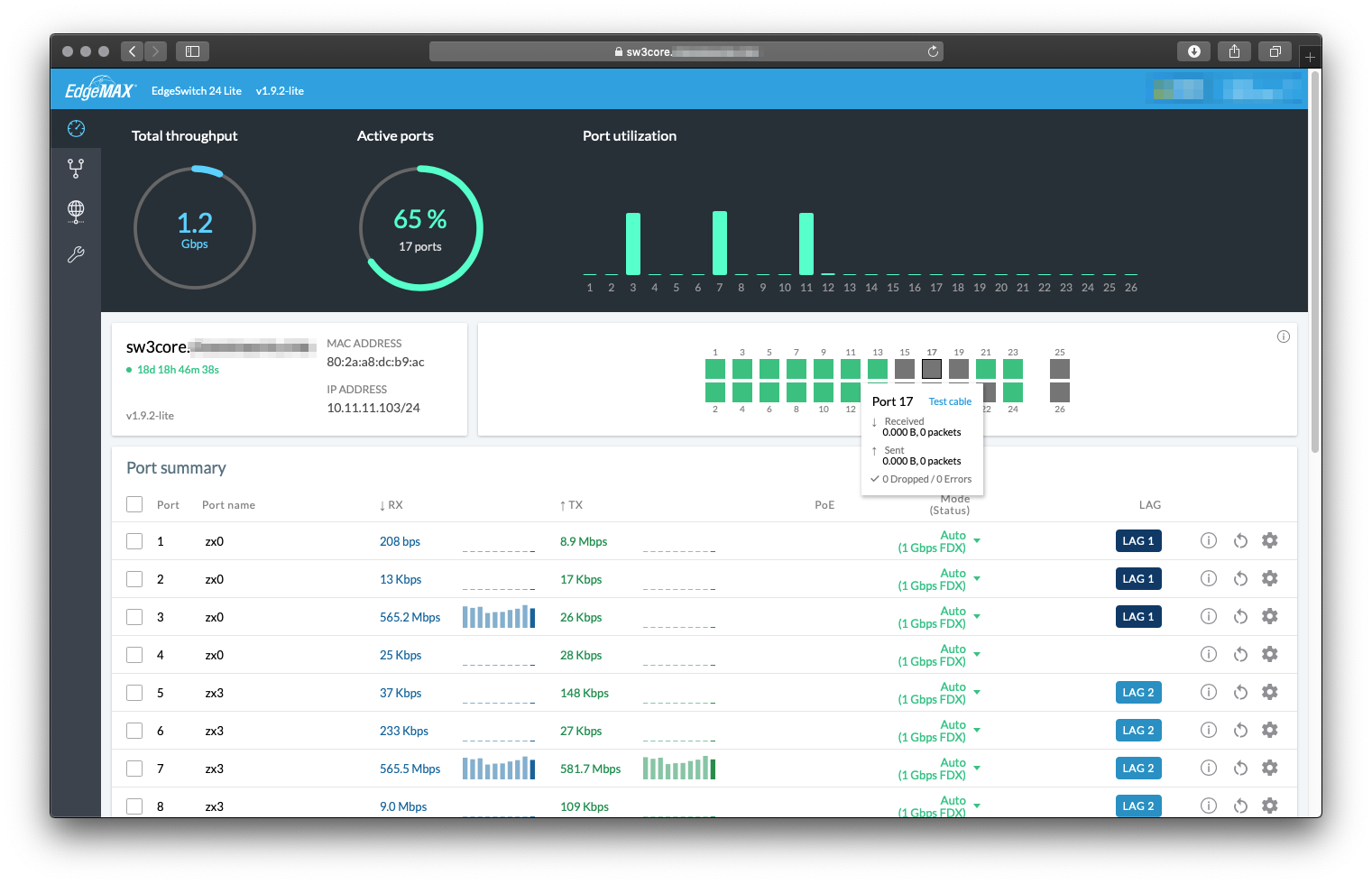

I'm experimenting with record size for my little VM datastore server but my first attempt didn't go so good from the looks of it.
Performance dropped, well, technically I'm just moving the VMs into place from another storage server so I've no real basis for comparison except about a month back when I was using FreeNAS (v11 not 12, same hardware, same VMs) for the same purpose but over iSCSI and it was ridiculously fast and that was without metadata VDEV unlike now. The only problem with that is that VMDKs were being corrupted, I learned this is a thing on VMDK virtual disks over iSCSI so I had to switch to NFS.
I'm trying to find the right size for the records size but so far it's not that easy. Using this command to calculate a record sizes, once the special_small_blocks were set now yields a buttload of stuff:

The smaller went to TrueNAS, not without first almost going insane trying to set up networking in TrueNAS SCALE, I figured, if I was going to screw thing up, better make it count. I reinstalled TrueNAS Core when I gave up, backed up the last 2GB of container data I forgot and started emptying the Synology cache. It took a while. Swapped the disks, rebuild on DiskStation, considered degrading the ZFS pool to move data but then I remembered VDEVs cannot be mirrored later on like any other system can (WHY!?) so I just destroyed it.
Recreated and rasynced the container data back to it and noticed this:
I wasn't particularly impressed until I looked closer, that bytes, not bits. Over 400Mb/s transfer or very random files, about the standard SATA-based flash drive speeds. It made me sit up upright back again.
When I started moving that annoying VM that has made me waste so much time, I got distracted and forgot for like an hour or two and when I got back it was already done. This VM took a whole day previous times. I got again distracted and until now I'm moving the rest and it peaking well over a gigabit per second, I'm unsure why since the bottleneck would be at 400-ish Mb/s of the SLOG mirrored VDEV but I ain't questioning, I'm just happy to see those numbers without anything stalling anywhere.
Strangely TrueNAS is barely breaking idle networking:
But on ESXi, vCenter and I assume a few minutes later vRealize Operations Manager and SNMP the data is/willbe there. On the network switches is updated the fastest and can be seen in near real time:

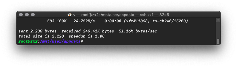

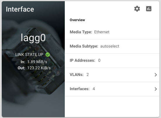

It's very impressive for an old cheap system with no investment. I can't imagine the performance I'd get on one of the bigger, proper servers stored away and with a little money put on it. For my needs though, it's overkill, but I'll keep an eye if iX Systems starts selling systems a little bigger than the home line but smaller than enterprise and with SCALE instead of the FreeBSD-based. VDEV removability is a must too. ZFS as impressive as it is, it's too daunting to go mainstream and other filesystems with similar features, namely Btrfs but the bigger being the Apple-controlled APFS and that's not good for anybody. Even XFS announced COW support a while ago. I have still not seen it (and it definitely isn't a volume manager) but it's coming.
