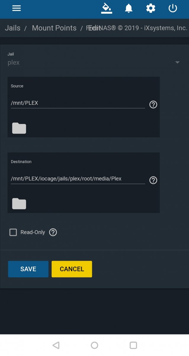

I have no spaces and I have the same problem
9,700
I don't think your source can be a container of the target...
Try putting your media in a different subdirectory of /mnt/PLEX like /mnt/PLEX/media

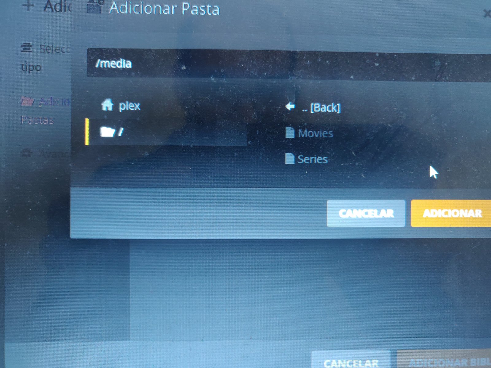

Now I have another problem Plex don't find open the floder and in the Plex floder ha have the movie floder.
mjk79
Nov 4, 2014
67

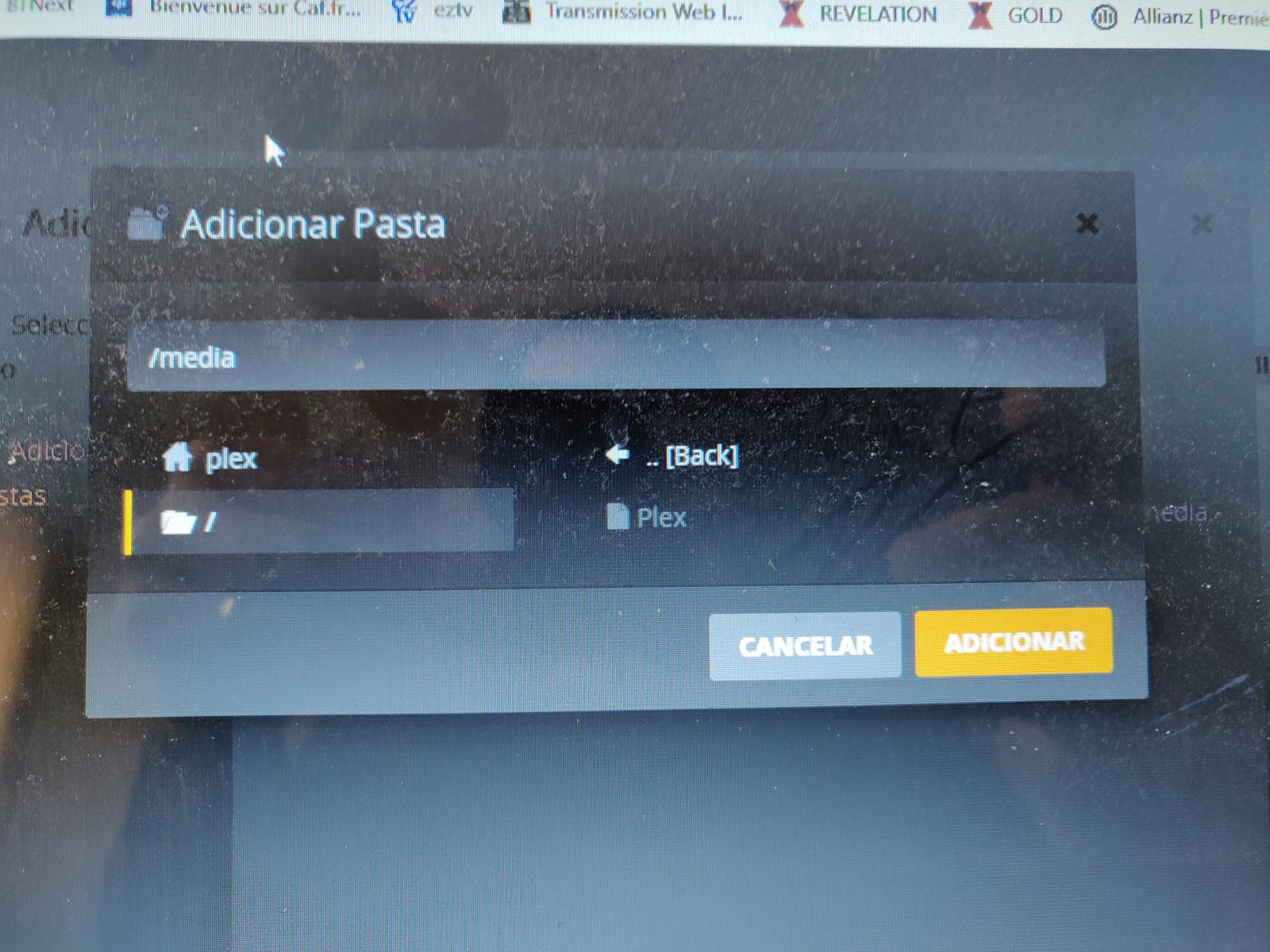

Your screen shot is showing the contents of the /media dir. As you can see on the right, there is a folder called "Plex" are you able to click on that?
or just type in the path. /media/Plex
ukinami
Nov 9, 2019
22

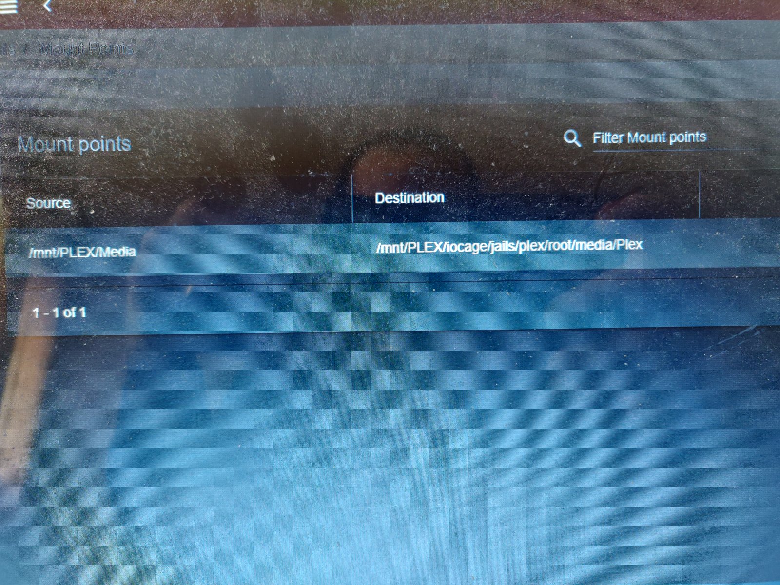

No that's is where I have the money point and im not able to click and when I type /media/Plex nothing append because on Plex floder I have the movies floder and series floder
mjk79
Nov 4, 2014
67

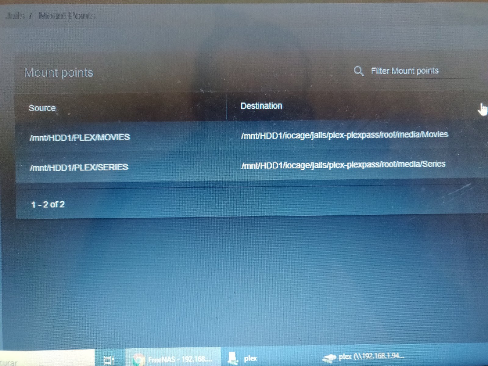

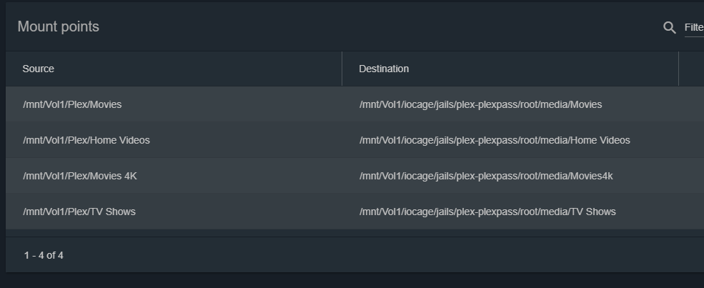

Post a screen shot of your mount points, it should look something like this.
/media/Plex/Movies
/media/Plex/Series
