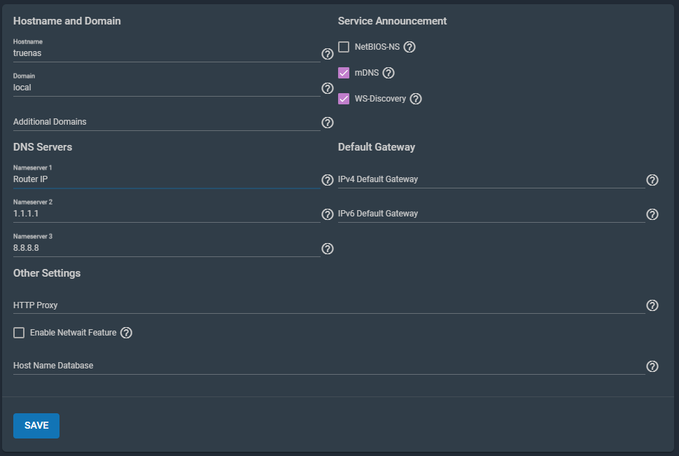

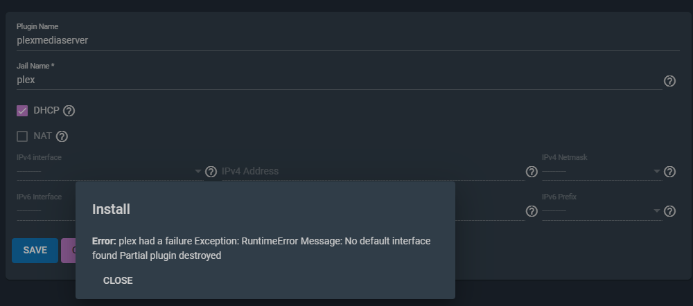

Hello, im having trouble setting up plex. Ive read a few forum posts with similar issues. Plex is failing to install with the following issue after ive set up my routers IP as the 1st DNS. Im not sure what to do, NAT and setting the ip manually also fail.

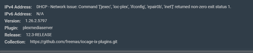

Edit: My truenas version is 12.0-U8.1. The plugin installed using NAT however im getting this error that was happening when i first installed it

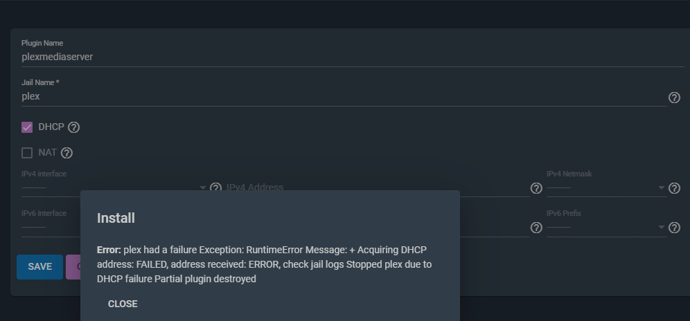

If i change the jail settings to DHCP it says IPv4 DHCP (not running) with the following error codes on the plugin

Add the IP of your router in the field "IPv4 Default Gateway" in the Network > Global Configuration section.

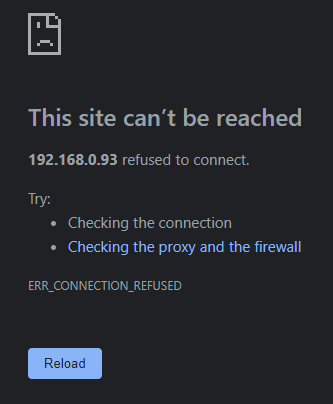

It's giving me the same errors, IPv4 error or DHCP not running when using DHCP and Berkely packet filter and VNET. and the managment portal wont load with NAT
