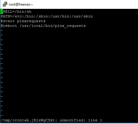

I can't seem to get PlexConnect.net to run at the start of the jail via cron. When I crontab -e I have this:
And when I enter the command:
/usr/local/bin/screen -S plex_requests /usr/local/bin/mono /var/db/plex_requests/PlexRequests.exe
it starts up just fine, I can CTRL+D or A and get out of it and it will continue running. It just doesn't run at the start of the jail.

Your command that works and the command that is listed in cron are 2 different commands.
DrMuffin
Feb 8, 2014
11
Ah yes, sorry that was a different command. But the plex_requests script INCSlayer instructed to make:
#!/bin/sh
cd /var/db/plex_requests
/usr/local/bin/screen -d -m -S plex_requests /usr/local/bin/mono /var/db/plex_requests/PlexRequests.exe
works fine when I enter the two commands manually in the jail. It doesn't run if I restart the jail however

Is the script executable?
What happens when you run the script manually? It seems like you're bypassing one key step in troubleshooting.
DrMuffin
Feb 8, 2014
11
well you're absolutely right, something is wonky with the script. It has 755 permissions but when I run it I get this:
root@plexrequests:/usr/local/bin # sh plex_requests
: No such file or directory
I downloaded the copy off the server to check it out, but it is correct. I can copy both lines and they work just fine :\

I don't understand what command you tried to run here.
Where is the script actually located?
Have you tried to CD into the directory and just run ./nameofscript
It's in /usr/local/bin, and it is just a file called plex_requests as per the instructions posted.
I did try that, it gives me:
root@plexrequests:/usr/local/bin # ./plex_requests
./plex_requests: Command not found.

Then your script is not right or it is not marked as executable
Chmod +x plex_requests
That's what I thought too
root@plexrequests:/usr/local/bin # chmod +x plex_requests

I don't know how else I can say that your script is not correct. Have you edited the script? Is it missing the first line?
DrMuffin
Feb 8, 2014
11
Welp, from what I could tell the content of the script was right but I decided to just remake it in nano and whatdya know now it works. I'm comparing the old and the new one I made in nano and they're exactly the same size and everything which is weird, but who cares it works now! Thanks
