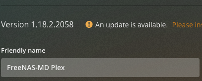

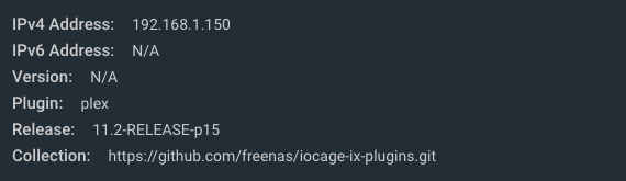

i'm running the plex plugin on freenas 11.2-u7. i went through the normal plugin installation and everything is working fine except for one minor thing. in the freenas web gui, when i go to the list of installed plugins, the version that is shown for plex is N/A. the actual version, as reported by plex, is 1.18.2.2058. has anyone else seen this and is there a fix? also, will this prevent me from updating plex?

Newer versions of Plex are only compatible with 11.3 Release. Your going to need to rebuild the jail with the 11.3 release version of Plex to update any farther. Might need to upgrade Freenas to 11.3 as well because I'm not sure you can get the Plex 11.3 Release version without upgraded FreeNas itself to 11.3

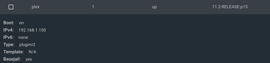

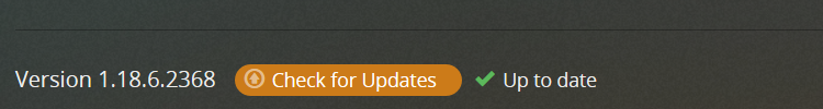

Can you explain this a bit more? I did upgrade FreeNAS to 11.3 and did an update on the plex jail and plugin and this is what i see:

Everything seem to be working just fine. Are you saying that i will not be able to update Plex any further?

Yes, your Plex is running on 11.2 RELEASE-p15 So your need to delete that jail and reinstall it using the 11.3-RELEASE. The 11.2 OS version will not let you upgrade to any newer Plex versions because they arent compatible with the new 11.3 OS version.

Interesting enough, my Plex version is same level as the one listed in 11.3

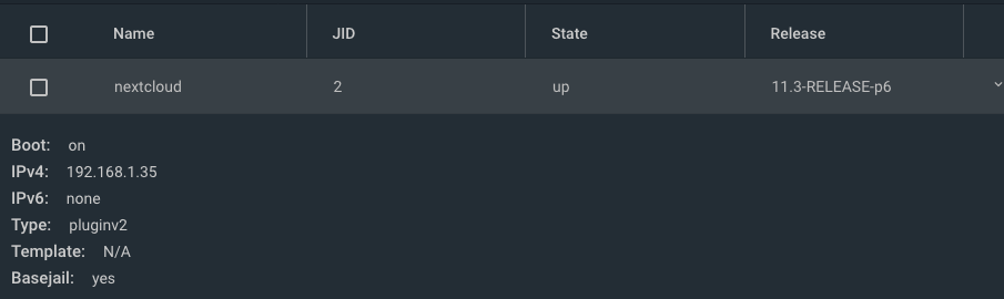

Well, i did a test on the Nextcloud jail with the iocage upgrade command you mentioned earlier and that worked like a charm! I did encounter an issue with the installed Nextcloud plugin version being higher than the one from the 11.3 plugin but i managed to fix that afterwards.
