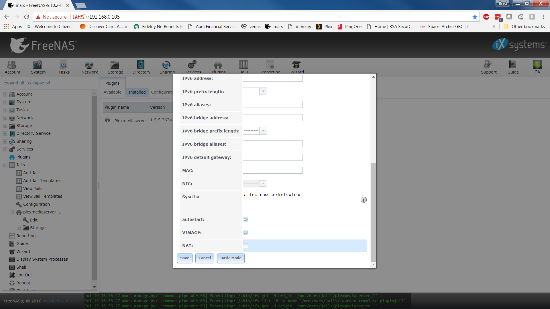

Is VIMAGE enabled in the jail advanced settings?
So under the jails config, that setting does not present itself. However when I manually create a jail, VIMAGE is checked.

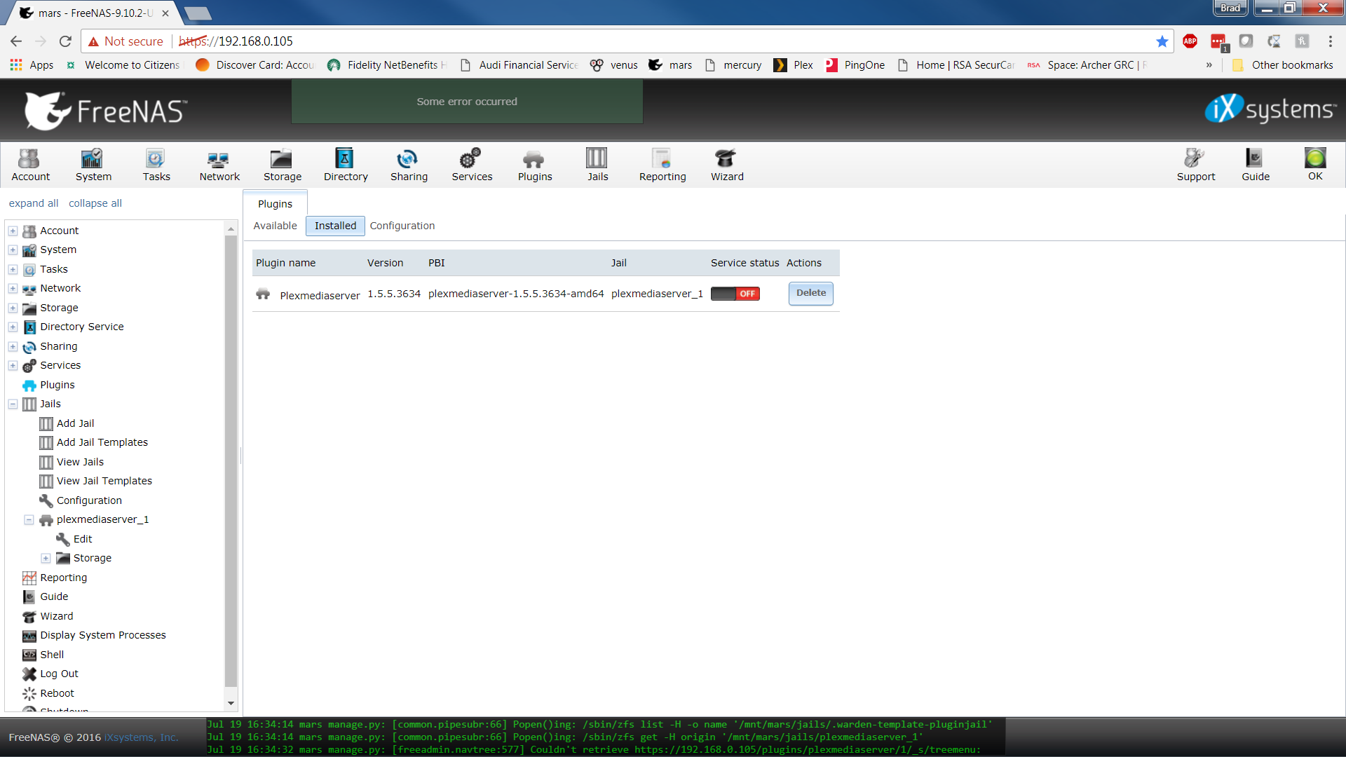

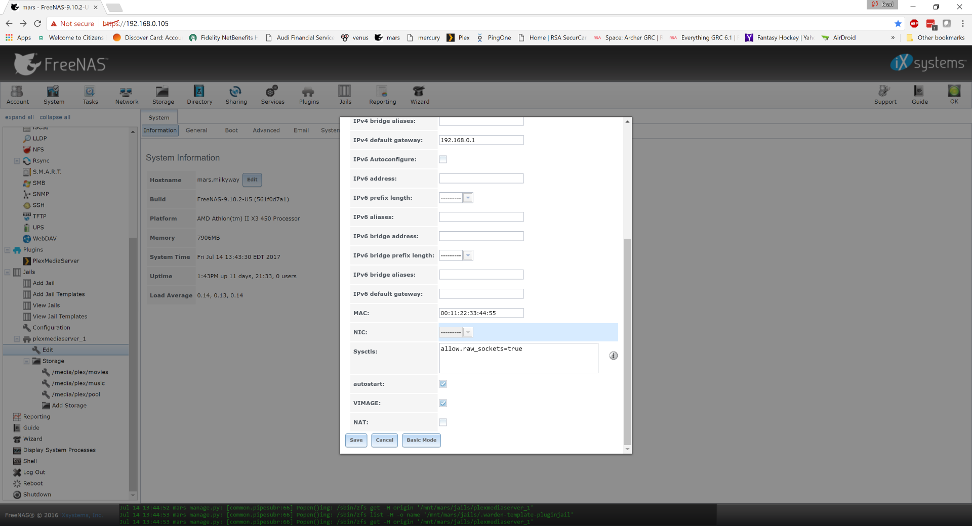

I am having the same issue. The jail automatically chose the IP of 192.168.0.2 but I would much prefer it to be 192.168.0.104. I tried to statically assign but it fails to start the service and throws an error (below). When I tell it to use DHCP it ignores what my static dhcp lease is configured to be (I chose a fake MAC address though, which is perhaps the problem?). I told it to use the MAC address of 00:11:22:33:44:55 and then in my router (pfSense) assigned that MAC to 192.168.0.104. However, when trying to use DHCP it ignores that and still binds to 192.168.0.2. Please let me know how to fix this. The error is below and 192.168.0.105 is the IP address of the FreeNAS host machine.
Jul 13 17:00:03 mars manage.py: [freeadmin.navtree:577] Couldn't retrieve https://192.168.0.105/plugins/plexmediaserver/1/_s/treemenu: ('timed out',)

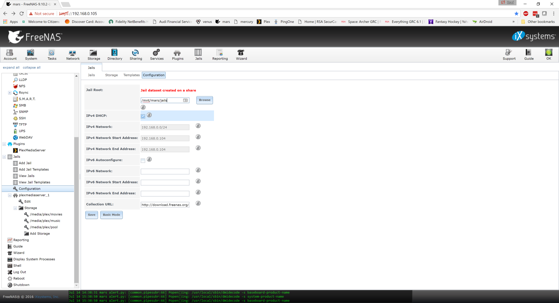

There should be a setting in the Jails configuration accessed from the left side bar that defines the starting IP for Jails, also used by Plug-ins. Thought 192.168.0.104 being your desired address means you could easily go in to your router and change that setting with even less effort. Just move the DHCP starting address up to 10 or 20 instead of 2.

On the configuration tab select Advanced to see the options to change the IP range.

I have already done that (assuming the screenshot below is what you are referring to). My issue seems to be that the IP address is not being honored. I put in a phony MAC address and then also went into my pfSense router and set up a static lease for that MAC address but it still wants to take the 192.168.0.2 address. Am I doing something wrong or is this a bug? Is there any reason why I shouldn't go into shell mode and manually modify the jail config? I have experience doing that for standard FreeBSD servers, but have never attempted to modify the jails in FreeNAS.

No that's not it. In the jails section click on the configuration tab and then click on Advanced. You can limit the IP range there to what you want.

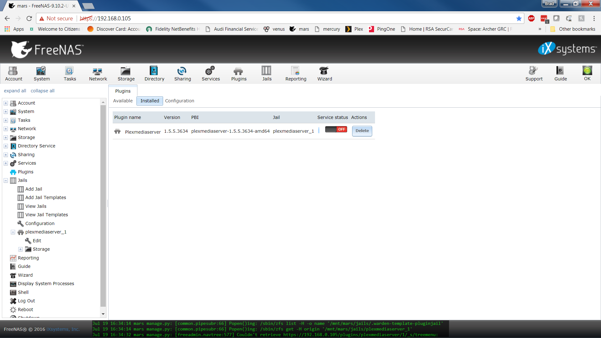

Ah gotcha, thanks. When I update it, I get that error in red. Is that expected (may not actually be an error?) Let me know please and I will make the other mods and try to re start the service and test it all out. I think I should also check the DHCP option right, or will this force a static IP and then I can delete my mapping in pfSense? IDC either way as long as the jail gets 192.168.0.104.

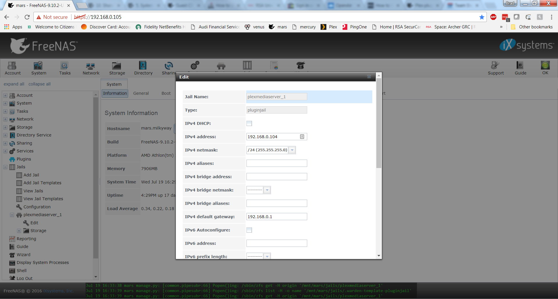

Are you trying to change your jails dataset? And the reason you can't assign a static IP to your jail is you have DHCP enabled. If you want to set a static IP you have to uncheck the DHCP box.

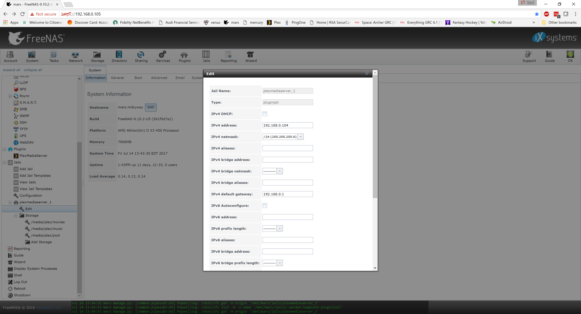

No I just want to change the IP AFAIK, not the dataset. When I uncheck DHCP and specify the address I want, it still picks 192.168.0.2. I was hoping selecting DHCP and forcing the static lease in the router would help but it does not. I will send a screenshot of the configuration I am hoping to use. Hopefully we can figure out why it is not taking the IP that I specify.

This is the configuration I used when not selecting DHCP.
Then the service fails to start with the same error showing in the console as the one before.
I didnt notice any differences when using NAT vs not.

i had the same issue, and after reading this thread, i couldnt find away around it, other than setting the ip range i want my plugins to be in, from the jails configuration tab:
and then deleted and re-installing the plugins all over again. thankfully the storage attached persists, but you do have to reinitialize the plugins.
after this the plugins ips are still being set by freenas, but at least they are sequentially in the range that i want them to be in.
