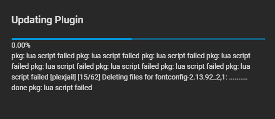

* Finally it tries to remove a bunch of packages, but it has a lot of problems with the "lua script"
pkg: Failed to execute lua script: [string "args = {}..."]:11: attempt to call a nil value (field 'filecmp')
[plexjail] [5/62] Deinstalling libvdpau-1.4...
pkg: lua script failed

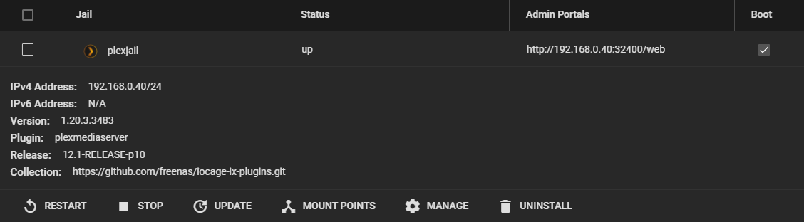

In the end, my jail seems upgrade to 12.1
Also Plex itself, also still seems to work properly

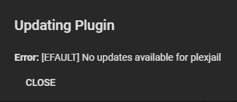

But the update functionality of the jail seems to be broken now...
I see A LOT of "lua script" errors popping up, when trying to update...
