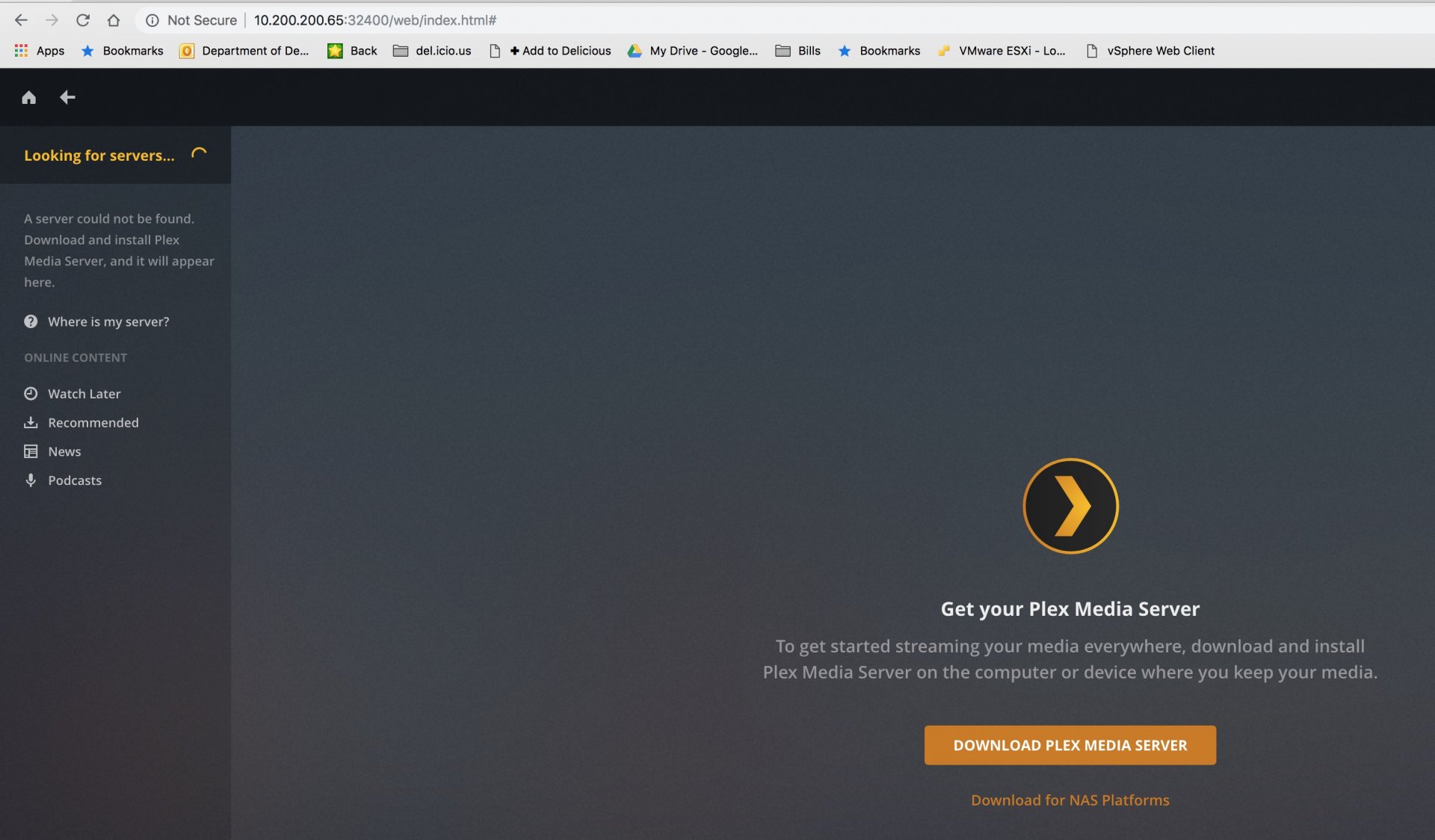

dinklebrow
Nov 19, 2018
5
Hi. "incognito" mode gives me the same, I only see my other plex server. I created an new plex account and just like my main plex account, I only get the 'Looking for servers...' message.
Just for the record, the IP address for the other plex server, and the IP address for the new plex server, are on PRECISELY the same LAN network/netmask? I see you're using a 10.x.x.x IP address, and that always makes me nervous, because that usually means someone has gotten "clever" with their home network.
dinklebrow
Nov 19, 2018
5
Yes, they are on the same network. I wouldn't say that using the 10.x.x.x network is "clever" as you would say and no reason to be nervous about it. It is just a network. I am familiar with designing/running networks as I work in this field during my day job.
I also created a separate Plex account and logged in with that and it will hang at the Looking for Servers (just like the screen shot I provided earlier). I also shut down the other server and get the same Looking for Servers. Could it be a permission issue somewhere? Not sure what else to do.
