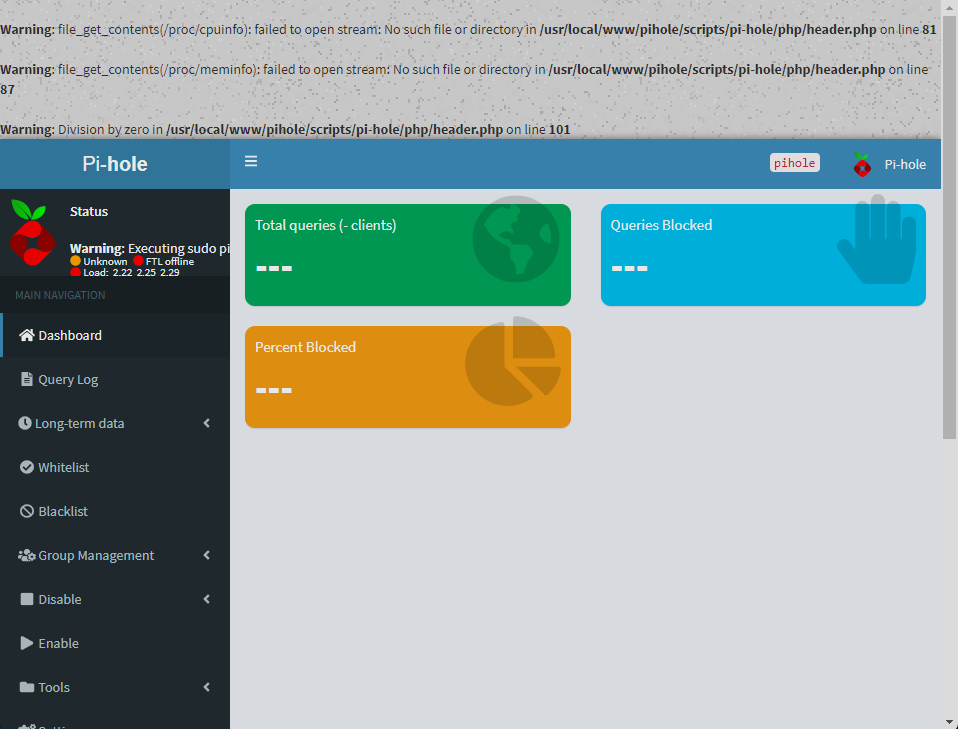

This is how far I got

Sadly no. Pi-hole uses its own dns service (pinhole-FTL), someone else made it work for FreeBSD quite some time back. Sadly he said he won’t actively work on it and that version while it runs on FreeBSD has some issues. It keeps 1 cpu core pinned at 100% which is not ideal.
I really thought initially this would be a few dependencies and a lamp server. Unfortunately till someone is willing to maintain pi-FTL this is a no go. That thread has been open for years and no one from the FreeBSD community, with the expertise needed has helped that one user.
Since he did manage to get it to compile, at least some base work has been done.
