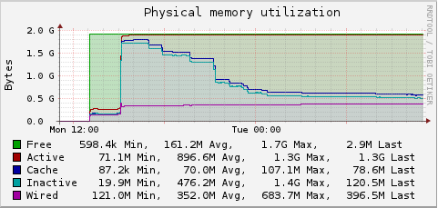

This is interesting here. The first two hours of the machine being up, you can see the 2 gigs of ram just sitting there, waiting to be used. As soon as the xfer begins, utilization ramps to essentially 100%. A couple hours later, the cached and inactive values begin to come down. The plateau for an hour at a time or so, and continue to drop slowly over the length of the xfer.

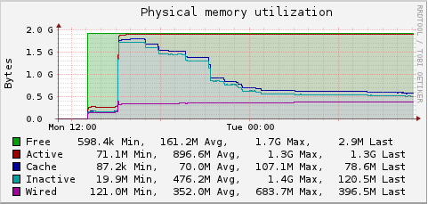

![2-Memory Usage.PNG 2-Memory Usage.PNG](https://www.truenas.com/community/data/attachments/0/115-eb02944018927f1362bd4073ca172a28.jpg)

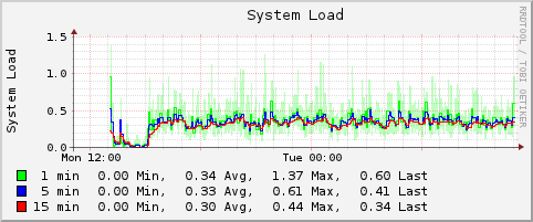

![3-System Load.PNG 3-System Load.PNG](https://www.truenas.com/community/data/attachments/0/116-1d3ec5f76816cca244303021db78ae27.jpg)
System Load doesn't seem to be particularly interesting to me, but you can see this and use it as a frame of reference for your own setup if it helps.

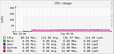

![1-CPU Usage.PNG 1-CPU Usage.PNG](https://www.truenas.com/community/data/attachments/0/117-8187f511bc05e7f1e435660a2c242f80.jpg)
CPU utilization stays very low. Remember, it's a straight up file copy.

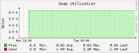

![5-Swap Utilization.PNG 5-Swap Utilization.PNG](https://www.truenas.com/community/data/attachments/0/118-adc28f62254f018a23af158e8f264179.jpg)
Nothing of interest here with the swap.

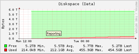

![6-Diskspace.PNG 6-Diskspace.PNG](https://www.truenas.com/community/data/attachments/0/119-49737989e2a4021be5998ebb674ea082.jpg)
As expected, the total disk usage is creeping upwards slowly. I'd rather a zoomed in map to show it more accurately, but you get the picture.
