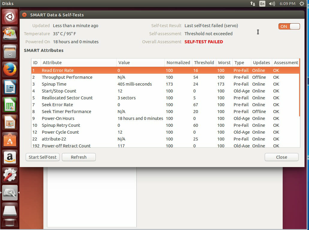

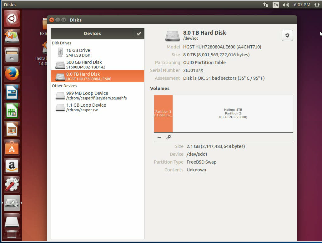

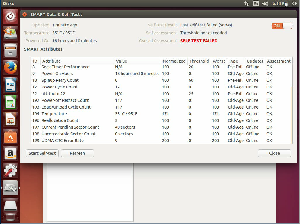

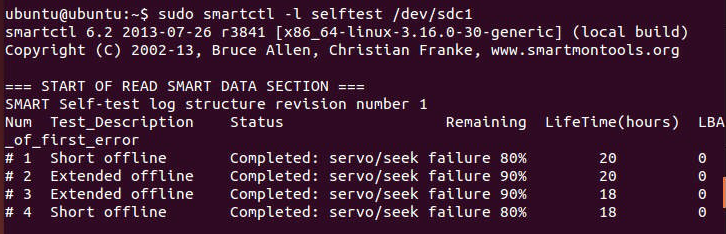

I think I figured it out.. I booted my Ubuntu live cd and just did a search for SMART and it came up with a disk section and a place to do tests.
I'm not sure how to post smartctl output.. but here are my screenshots... It's not looking good for the first drive:

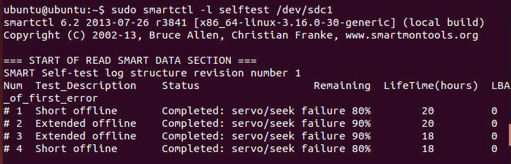

I got smartmontools installed finally. here's what I get from it:
Looks like a bad servo to me. This was done on different system. Is there anything else I should do before I call to RMA the drive?

The second mirrored drive had the exact same results
I opened the other two HE8 drives I had and the short test, just to see what a successful (hopefully) test would look like. they did pass, but one thing I noticed Immediately was how quiet the other two drives were. those first two must have been a bad lot because they both had the exact same very noticeable and very noisy vibration.
Thank you to everyone for the help! I would have been just lost, thinking I had something wrong.

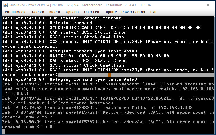

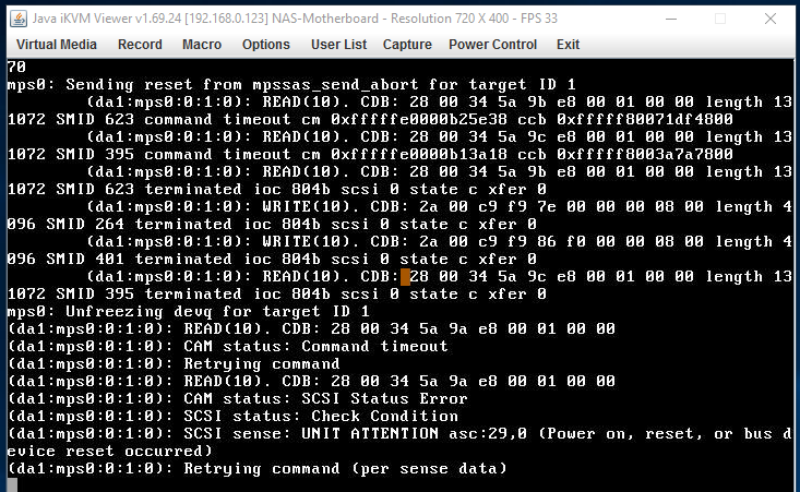

so far so good... until I looked at my console and noticed this:
/da0 = HGST HE8 drive
/da1 = HGST HE8 drive
/da2 = Seagate Archive drive
The two HGST drives have errors, the Seagate Drive does not.
I ran smartctl -a on each drive to see if it reported any information about the errors.. I don't understand the details of this, but I'm hoping one of the experts here will be able to tell me something. Here are the reports from all 3 drives:

  After command completion occurred, registers were:
  ER ST SC SN CL CH DH
  84 41 00 00 00 00 00  Error: ICRC, ABRT at LBA = 0x00000000 = 0
  Commands leading to the command that caused the error were:
  CR FR SC SN CL CH DH DC  Powered_Up_Time  Command/Feature_Name
  60 00 08 e8 f6 59 40 00  14:58:49.791  READ FPDMA QUEUED
  60 00 10 e8 f7 59 40 00  14:58:49.790  READ FPDMA QUEUED
  60 00 00 e8 f5 59 40 00  14:58:49.790  READ FPDMA QUEUED
  60 00 00 e8 f4 59 40 00  14:58:49.776  READ FPDMA QUEUED
  60 00 10 e8 f3 59 40 00  14:58:49.776  READ FPDMA QUEUED
Num  Test_Description  Status  Remaining  LifeTime(hours)  LBA_of_first_error
# 1  Short offline  Completed without error  00%  15  -
# 2  Short offline  Completed without error  00%  2  -
# 3  Short offline  Completed without error  00%  0  -
  1  0  0  Not_testing
  2  0  0  Not_testing
  3  0  0  Not_testing
  4  0  0  Not_testing
  5  0  0  Not_testing
HGST HE8
[root@freenas] ~# smartctl -a /dev/da1
smartctl 6.3 2014-07-26 r3976 [FreeBSD 9.3-RELEASE-p31 amd64] (local build)
Copyright (C) 2002-14, Bruce Allen, Christian Franke, www.smartmontools.org
Device Model:  HGST HUH728080ALE600
Serial Number:  2EHS4VEX
LU WWN Device Id: 5 000cca 23bd89e41
Firmware Version: A4GNT7J0
User Capacity:  8,001,563,222,016 bytes [8.00 TB]
Sector Sizes:  512 bytes logical, 4096 bytes physical
Rotation Rate:  7200 rpm
Form Factor:  3.5 inches
Device is:  Not in smartctl database [for details use: -P showall]
ATA Version is:  ACS-2, ATA8-ACS T13/1699-D revision 4
SATA Version is:  SATA 3.1, 6.0 Gb/s (current: 6.0 Gb/s)
Local Time is:  Tue Feb  9 05:17:53 2016 PST
SMART support is: Enabled
General SMART Values:
Offline data collection status:  (0x80) Offline data collection activity
  was never started.
Self-test execution status:  (  0) The previous self-test routine completed
  been run.
data collection:  (  101) seconds.
capabilities:  (0x5b) SMART execute Offline immediate.
  command.
  Self-test supported.
  No Conveyance Self-test supported.
SMART capabilities:  (0x0003) Saves SMART data before entering
  power-saving mode.
Error logging capability:  (0x01) Error logging supported.
Short self-test routine
recommended polling time:  (  2) minutes.
Extended self-test routine
recommended polling time:  (1292) minutes.
SCT capabilities:  (0x003d) SCT Status supported.
  SCT Data Table supported.
ID# ATTRIBUTE_NAME  FLAG  VALUE WORST THRESH TYPE  UPDATED  WHEN_FAILED RAW_VALUE
  1 Raw_Read_Error_Rate  0x000b  100  100  016  Pre-fail  Always  -  0
  2 Throughput_Performance  0x0005  100  100  054  Pre-fail  Offline  -  0
  3 Spin_Up_Time  0x0007  100  100  024  Pre-fail  Always  -  0
  4 Start_Stop_Count  0x0012  100  100  000  Old_age  Always  -  1
  5 Reallocated_Sector_Ct  0x0033  100  100  005  Pre-fail  Always  -  0
  7 Seek_Error_Rate  0x000b  100  100  067  Pre-fail  Always  -  0
  8 Seek_Time_Performance  0x0005  100  100  020  Pre-fail  Offline  -  0
  9 Power_On_Hours  0x0012  100  100  000  Old_age  Always  -  16
 10 Spin_Retry_Count  0x0013  100  100  060  Pre-fail  Always  -  0
 12 Power_Cycle_Count  0x0032  100  100  000  Old_age  Always  -  1
 22 Unknown_Attribute  0x0023  100  100  025  Pre-fail  Always  -  100
192 Power-Off_Retract_Count 0x0032  100  100  000  Old_age  Always  -  1
193 Load_Cycle_Count  0x0012  100  100  000  Old_age  Always  -  1
194 Temperature_Celsius  0x0002  166  166  000  Old_age  Always  -  36 (Min/Max 23/39)
196 Reallocated_Event_Count 0x0032  100  100  000  Old_age  Always  -  0
197 Current_Pending_Sector  0x0022  100  100  000  Old_age  Always  -  0
198 Offline_Uncorrectable  0x0008  100  100  000  Old_age  Offline  -  0
199 UDMA_CRC_Error_Count  0x000a  200  200  000  Old_age  Always  -  8
SMART Error Log Version: 1
ATA Error Count: 8 (device log contains only the most recent five errors)
  CR = Command Register [HEX]
  FR = Features Register [HEX]
  SC = Sector Count Register [HEX]
  SN = Sector Number Register [HEX]
  CL = Cylinder Low Register [HEX]
  CH = Cylinder High Register [HEX]
  DH = Device/Head Register [HEX]
  DC = Device Command Register [HEX]
  ER = Error register [HEX]
  ST = Status register [HEX]
Powered_Up_Time is measured from power on, and printed as
DDd+hh:mm:SS.sss where DD=days, hh=hours, mm=minutes,
SS=sec, and sss=millisec. It "wraps" after 49.710 days.
Error 8 occurred at disk power-on lifetime: 15 hours (0 days + 15 hours)
  When the command that caused the error occurred, the device was active or idle.
  60 00 18 e8 9c 5a 40 00  15:05:05.922  READ FPDMA QUEUED
  61 40 10 b0 86 f9 40 00  15:05:05.906  WRITE FPDMA QUEUED
  60 00 08 e8 9a 5a 40 00  15:05:05.906  READ FPDMA QUEUED
  61 08 10 00 7e f9 40 00  15:05:05.904  WRITE FPDMA QUEUED
  61 08 08 f0 86 f9 40 00  15:05:05.903  WRITE FPDMA QUEUED
Error 7 occurred at disk power-on lifetime: 15 hours (0 days + 15 hours)
  60 00 08 e8 9a 5a 40 00  15:04:05.788  READ FPDMA QUEUED
  60 00 10 e8 9b 5a 40 00  15:04:05.787  READ FPDMA QUEUED
  60 00 00 e8 99 5a 40 00  15:04:05.787  READ FPDMA QUEUED
  ea 00 00 00 00 00 00 00  15:03:38.833  FLUSH CACHE EXT
  61 08 00 98 29 81 40 00  15:03:38.833  WRITE FPDMA QUEUED
Error 6 occurred at disk power-on lifetime: 14 hours (0 days + 14 hours)
  60 00 08 e8 3c 5a 40 00  14:58:49.632  READ FPDMA QUEUED
  60 00 00 e8 3b 5a 40 00  14:58:49.631  READ FPDMA QUEUED
  2f 00 01 10 00 00 00 00  14:58:49.631  READ LOG EXT
  60 00 08 e8 3a 5a 40 00  14:58:49.628  READ FPDMA QUEUED
Error 5 occurred at disk power-on lifetime: 14 hours (0 days + 14 hours)
  60 00 08 e8 3a 5a 40 00  14:58:49.631  READ FPDMA QUEUED
  60 00 00 e8 39 5a 40 00  14:58:49.628  READ FPDMA QUEUED
  60 00 10 e8 38 5a 40 00  14:58:49.621  READ FPDMA QUEUED
  60 00 10 e8 37 5a 40 00  14:58:49.621  READ FPDMA QUEUED
  60 00 08 e8 35 5a 40 00  14:58:49.621  READ FPDMA QUEUED
Error 4 occurred at disk power-on lifetime: 14 hours (0 days + 14 hours)
  60 00 08 e8 34 5a 40 00  14:58:49.611  READ FPDMA QUEUED
  60 00 10 e8 35 5a 40 00  14:58:49.610  READ FPDMA QUEUED
  60 00 00 e8 33 5a 40 00  14:58:49.610  READ FPDMA QUEUED
  60 00 00 e8 32 5a 40 00  14:58:49.605  READ FPDMA QUEUED
  60 00 10 e8 31 5a 40 00  14:58:49.604  READ FPDMA QUEUED
  1  0  0  Not_testing
  2  0  0  Not_testing
  3  0  0  Not_testing
  4  0  0  Not_testing
  5  0  0  Not_testing
Seagate Archive
[root@freenas] ~# smartctl -a /dev/da2
Device Model:  ST8000AS0002-1NA17Z
Serial Number:  Z840A26X
LU WWN Device Id: 5 000c50 08732fc16
Firmware Version: AR15
Rotation Rate:  5980 rpm
ATA Version is:  ACS-2, ACS-3 T13/2161-D revision 3b
Local Time is:  Tue Feb  9 05:20:14 2016 PST
Offline data collection status:  (0x82) Offline data collection activity
  was completed without error.
  been run.
data collection:  (  0) seconds.
capabilities:  (0x7b) SMART execute Offline immediate.
  command.
  power-saving mode.
recommended polling time:  (  1) minutes.
recommended polling time:  ( 932) minutes.
Conveyance self-test routine
SCT capabilities:  (0x30a5) SCT Status supported.
SMART Attributes Data Structure revision number: 10
  1 Raw_Read_Error_Rate  0x000f  117  100  006  Pre-fail  Always  -  143127696
  3 Spin_Up_Time  0x0003  099  099  000  Pre-fail  Always  -  0
  4 Start_Stop_Count  0x0032  100  100  020  Old_age  Always  -  2
  5 Reallocated_Sector_Ct  0x0033  100  100  010  Pre-fail  Always  -  0
  7 Seek_Error_Rate  0x000f  063  060  030  Pre-fail  Always  -  2014545
  9 Power_On_Hours  0x0032  100  100  000  Old_age  Always  -  13
 10 Spin_Retry_Count  0x0013  100  100  097  Pre-fail  Always  -  0
 12 Power_Cycle_Count  0x0032  100  100  020  Old_age  Always  -  2
183 Runtime_Bad_Block  0x0032  100  100  000  Old_age  Always  -  0
184 End-to-End_Error  0x0032  100  100  099  Old_age  Always  -  0
187 Reported_Uncorrect  0x0032  100  100  000  Old_age  Always  -  0
188 Command_Timeout  0x0032  100  100  000  Old_age  Always  -  0
189 High_Fly_Writes  0x003a  100  100  000  Old_age  Always  -  0
190 Airflow_Temperature_Cel 0x0022  064  060  045  Old_age  Always  -  36 (Min/Max 26/40)
191 G-Sense_Error_Rate  0x0032  100  100  000  Old_age  Always  -  0
193 Load_Cycle_Count  0x0032  100  100  000  Old_age  Always  -  3
194 Temperature_Celsius  0x0022  036  040  000  Old_age  Always  -  36 (0 22 0 0 0)
195 Hardware_ECC_Recovered  0x001a  117  100  000  Old_age  Always  -  143127696
197 Current_Pending_Sector  0x0012  100  100  000  Old_age  Always  -  0
198 Offline_Uncorrectable  0x0010  100  100  000  Old_age  Offline  -  0
199 UDMA_CRC_Error_Count  0x003e  200  200  000  Old_age  Always  -  1
240 Head_Flying_Hours  0x0000  100  253  000  Old_age  Offline  -  13 (124 66 0)
241 Total_LBAs_Written  0x0000  100  253  000  Old_age  Offline  -  4034239292
242 Total_LBAs_Read  0x0000  100  253  000  Old_age  Offline  -  241586
No Errors Logged
# 1  Conveyance offline  Completed without error  00%  12  -
# 2  Short offline  Completed without error  00%  12  -
  1  0  0  Not_testing
  2  0  0  Not_testing
  3  0  0  Not_testing
  4  0  0  Not_testing
  5  0  0  Not_testing
Any suggestions on what I should look at?

Do these indicate something not working correctly with my network? One thing odd about my network is my computers generally show up in the file explorer 'network' section, but FreeNas does not show up.. however I can make drive mapping to FreeNas with it's IP address. Most of my network is Windows 10
The UDMA CRC errors might be a cabling issue. Power off the machine and swap out cables.
Just to clarify... Are you talking about the SATA cables?
anodos
Sambassador
Mar 6, 2014
9,554
The hostname lookup errors indicate that you don't have a local DNS server. Yes, SATA cables.

Is there some way to clear existing SMART errors after I change cables?
