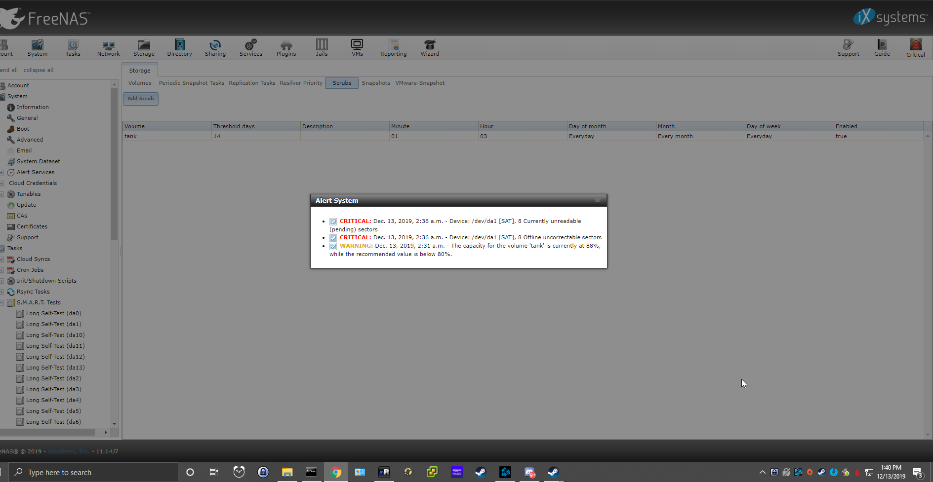

Hello all, love the community and have a few versions of my NAS over the years and love it. Went from 12X2 to now 12x @tb drives in a raidz2. I am getting an alert in the GUI that says I have unrecoverable errors and in the past this means drive is dying and replace it. I have many spare I can put in but in this case the first time I am not seeing "bad drive behavior" and in the past see a ton of counters going up but this time its not the case. I am also not seeing my short or long scheduled tasks or even my scrubs reflecting the error. I logged back in via IE and cleared cached thinking that might help but no love. I have also rebooted it and also have even tried to unplug the drive that has the errors for a bit then back in, this cleared if for a bit then it came back stating I have 8 unrecoverable sectors.
My question is how can I clear this until it goes up or just replace the drive for sure? As you can see in my notes below it seems fine on the pool status and also drive life wise its not that old I think.
Current status? I am running a smart scan on the problem drive again, I already ran scrub today. ANY help would be appreciated. :)

root@g-nas:~ # smartctl -q noserial -a /dev/da1

ID# ATTRIBUTE_NAME FLAG VALUE WORST THRESH TYPE UPDATED WHEN_FAILED RAW_VALUE
1 Raw_Read_Error_Rate 0x000f 118 099 006 Pre-fail Always - 188138240
3 Spin_Up_Time 0x0003 094 094 000 Pre-fail Always - 0
4 Start_Stop_Count 0x0032 100 100 020 Old_age Always - 25
5 Reallocated_Sector_Ct 0x0033 100 100 010 Pre-fail Always - 0
7 Seek_Error_Rate 0x000f 082 060 030 Pre-fail Always - 190619395
9 Power_On_Hours 0x0032 081 081 000 Old_age Always - 16891
10 Spin_Retry_Count 0x0013 100 100 097 Pre-fail Always - 0
12 Power_Cycle_Count 0x0032 100 100 020 Old_age Always - 25
183 Runtime_Bad_Block 0x0032 100 100 000 Old_age Always - 0
184 End-to-End_Error 0x0032 100 100 099 Old_age Always - 0
187 Reported_Uncorrect 0x0032 100 100 000 Old_age Always - 0
188 Command_Timeout 0x0032 100 100 000 Old_age Always - 0 0 0
189 High_Fly_Writes 0x003a 084 084 000 Old_age Always - 16
190 Airflow_Temperature_Cel 0x0022 061 051 045 Old_age Always - 39 (Min/Max 37/49)
191 G-Sense_Error_Rate 0x0032 100 100 000 Old_age Always - 0
192 Power-Off_Retract_Count 0x0032 100 100 000 Old_age Always - 22
193 Load_Cycle_Count 0x0032 100 100 000 Old_age Always - 106
194 Temperature_Celsius 0x0022 039 049 000 Old_age Always - 39 (0 24 0 0 0)
197 Current_Pending_Sector 0x0012 100 100 000 Old_age Always - 8
198 Offline_Uncorrectable 0x0010 100 100 000 Old_age Offline - 8
199 UDMA_CRC_Error_Count 0x003e 200 200 000 Old_age Always - 0
240 Head_Flying_Hours 0x0000 100 253 000 Old_age Offline - 16890h+11m+51.410s
241 Total_LBAs_Written 0x0000 100 253 000 Old_age Offline - 32727073012
242 Total_LBAs_Read 0x0000 100 253 000 Old_age Offline - 408717900121

Num Test_Description Status Remaining LifeTime(hours) LBA_of_first_error
# 1 Extended offline Completed: read failure 40% 16816 3661260384

root@g-nas:~ # zpool status
pool: freenas-boot
state: ONLINE
scan: scrub repaired 0 in 0 days 00:02:02 with 0 errors on Thu Dec 12 03:47:02 2019
config:
NAME STATE READ WRITE CKSUM
freenas-boot ONLINE 0 0 0
mirror-0 ONLINE 0 0 0
da13p2 ONLINE 0 0 0
da12p2 ONLINE 0 0 0
da11p2 ONLINE 0 0 0
errors: No known data errors
pool: tank
state: ONLINE
scan: resilvered 2.30M in 0 days 00:00:03 with 0 errors on Thu Dec 12 16:54:17 2019
config:
tank ONLINE 0 0 0
raidz2-0 ONLINE 0 0 0
gptid/8d5b769c-e05b-11e7-a0bd-0cc47a468a03 ONLINE 0 0 0
gptid/fd685775-61d9-11e8-ad3e-0cc47a468a03 ONLINE 0 0 0
gptid/8f430731-e05b-11e7-a0bd-0cc47a468a03 ONLINE 0 0 0
gptid/904d5078-e05b-11e7-a0bd-0cc47a468a03 ONLINE 0 0 0
gptid/9155c342-e05b-11e7-a0bd-0cc47a468a03 ONLINE 0 0 0
gptid/925ca178-e05b-11e7-a0bd-0cc47a468a03 ONLINE 0 0 0
gptid/9359086a-e05b-11e7-a0bd-0cc47a468a03 ONLINE 0 0 0
gptid/946ecf61-e05b-11e7-a0bd-0cc47a468a03 ONLINE 0 0 0
gptid/953f2a9e-e05b-11e7-a0bd-0cc47a468a03 ONLINE 0 0 0
gptid/963bf070-e05b-11e7-a0bd-0cc47a468a03 ONLINE 0 0 0
gptid/97467fa4-e05b-11e7-a0bd-0cc47a468a03 ONLINE 0 0 0

Update ( I hate those guys that do stuff and never update) I ran scrub and also did long smart scan, the smart scan triggered the unrecovrable sectors to go from 8 to now 10. Even though the counts in the zpool status errors is still zero this was enough to make me RMA the drive and but my extra drive in (since I have so many I keep and extra for my raidz2 just in case and never have downtime. Its going thought the resliver now.
IE I gave up and just replaced the problem child.
