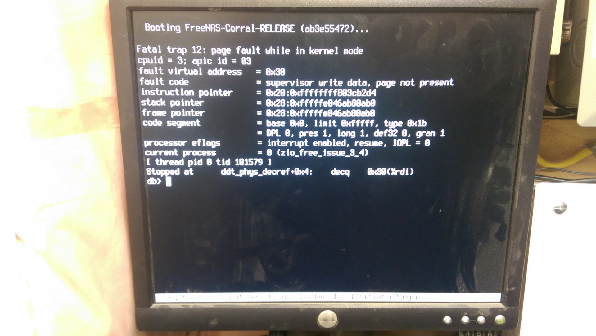

So, like, it rebooted and took a while to come up with this, maybe someone could help me decode it or point out some documentation on decoding messages like these, along with commands which may work at the debug prompt.
After this I just typed "reboot" and pressed enter.

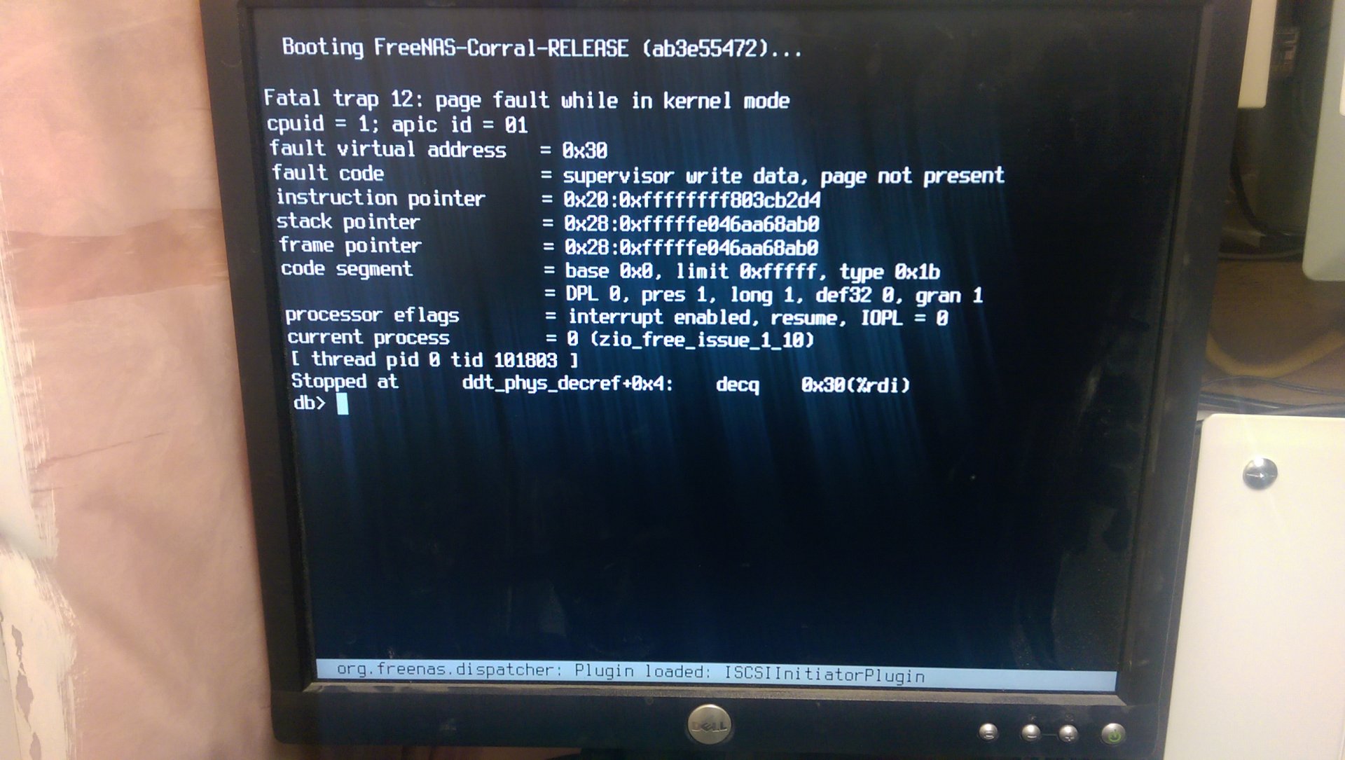

Lurkr
Mar 16, 2017
20
Seems to happen on every reboot, no web online, but the numbers in the error change only ever so slightly each time
Lurkr
Mar 16, 2017
20
Right after the plugin "ISCSIInitiatorPlugin" is loaded, the motherboard's disk light remains constantly on (lots of IOs/s) for a few minutes before reaching that debug prompt you see above. So whatever is loaded next in the boot sequence after the ISCSIInitiator seems to be choking up.
It may also be noted that I have not turned on or touched any settings related to ISCSI after fresh install, and don't need to

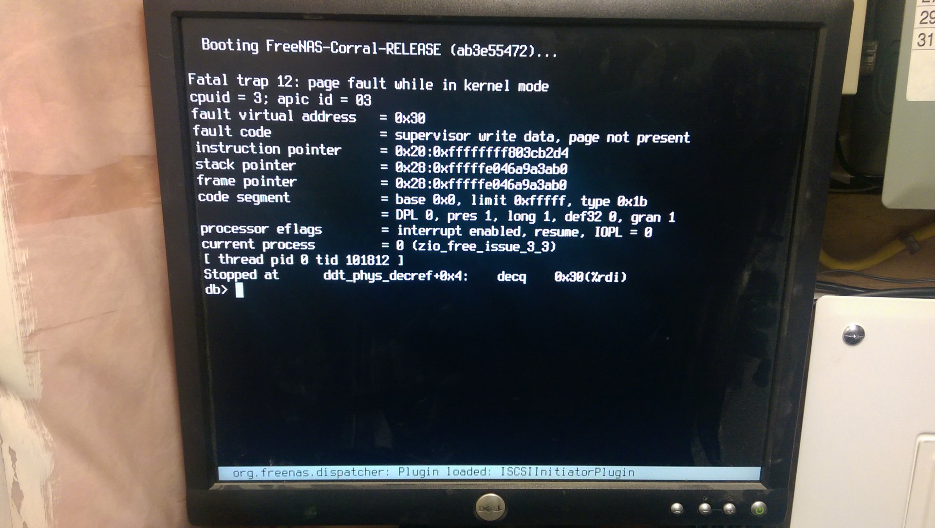

Lurkr
Mar 16, 2017
20
The Instruction Pointer seems to be the same in every freeze, but the Stack Pointer and the Frame Pointer seem to be identical to each other but different (and ascending) in each picture I'm posting.
It could be that it is slowly repairing, and each error it needs a reboot, and then each time its rebooted it gets a little touch further.
Next time it happens I'm going to try to boot to previous evironment (where the pool was not imported yet) and import using -N flag, and try running a scrub. It'll take about two weeks, but maybe by then some suggestions will fly around as to what little things I should check, or where my attention should be focused on in order to troubleshoot it properly.

So, waiting for a scrub to complete has not repaired anything, here is the outputs of:
zpool status -v TPS
zfs list
zfs destroy TPS/ISO1
which then panicked the server.
