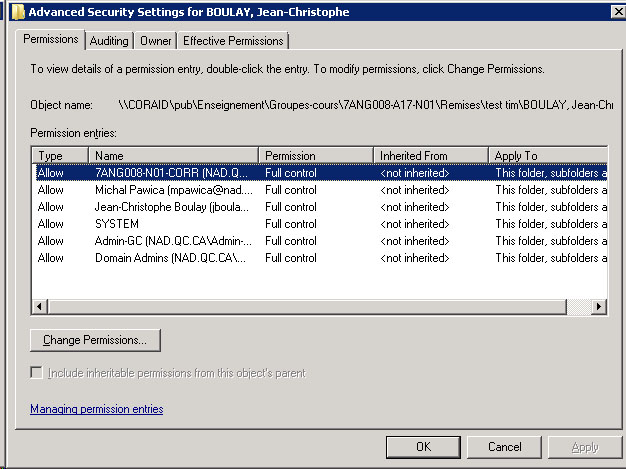

Here are the resulting permissions on the folder created on a share hosted a Windows server :
and same thing on a FreeNAS server:
FreeNAS seems to be adding inherited permissions. I also tested the script on a share mounted on a Fedora 26 server configured with Samba using a default configuration and winbind for account mapping. The share was mapped to an XFS partition and using acl_xattr VFS module to store permissions. The result on the linux server was the same as in Windows.

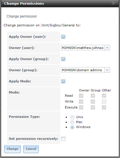

How do you have the dataset configured? Did you uncheck set permission recursively?

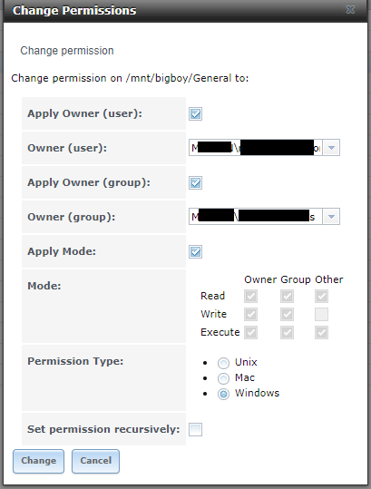

The same way as you. Set permissions recursively is unchecked. This appears to be a bug as I did some initial tests on a new FreeNAS server and the permissions were correct. When I ran the script again, the permissions were messed up. Where are the ACLs stored?
