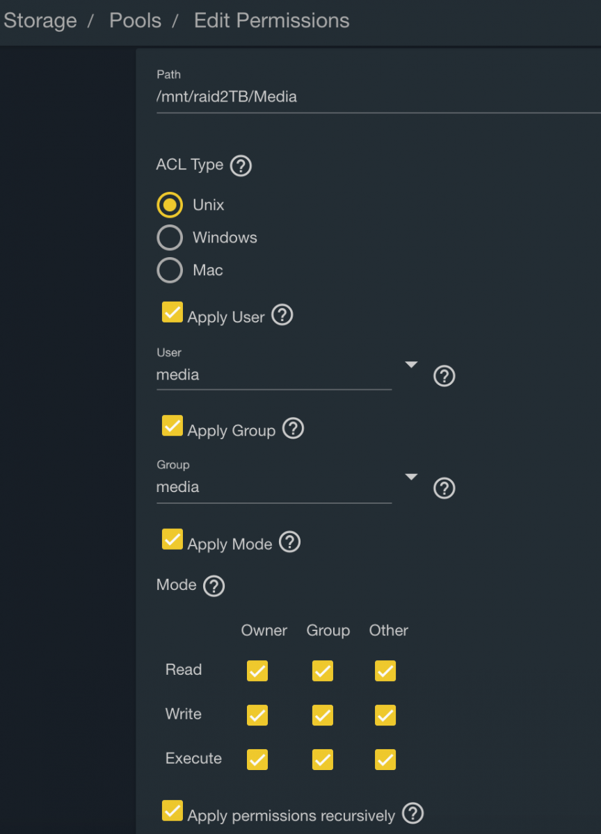

@SweetAndLow Sorry if I wasn't clearer enough. I have a dataset called Media where the owner and the group is media. I have a user which is also part of the group media. Here is how the permissions for the Media dataset look like:

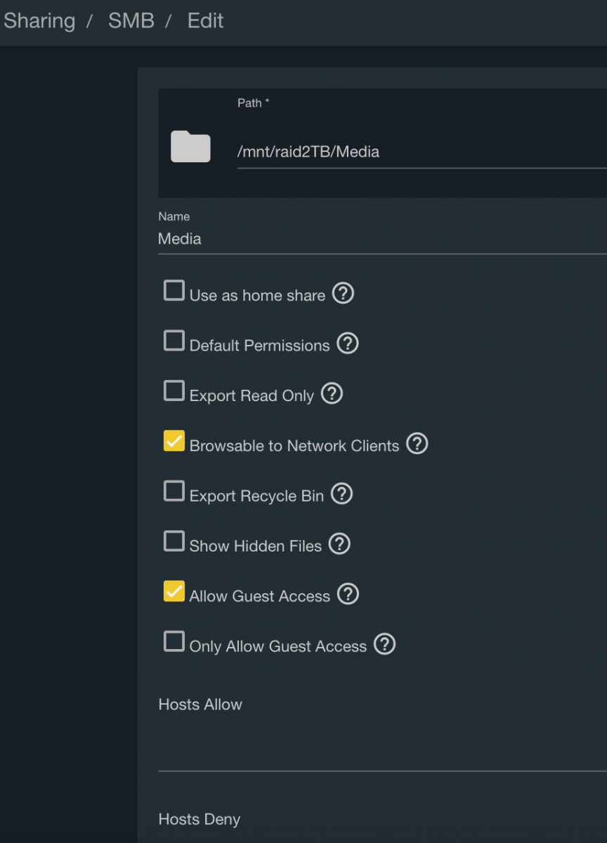

Now I have an SMB share who looks like this:
When I click ok and browse to this location via Finder in the Mac and login as the user, I can delete remove and move files with no problems.

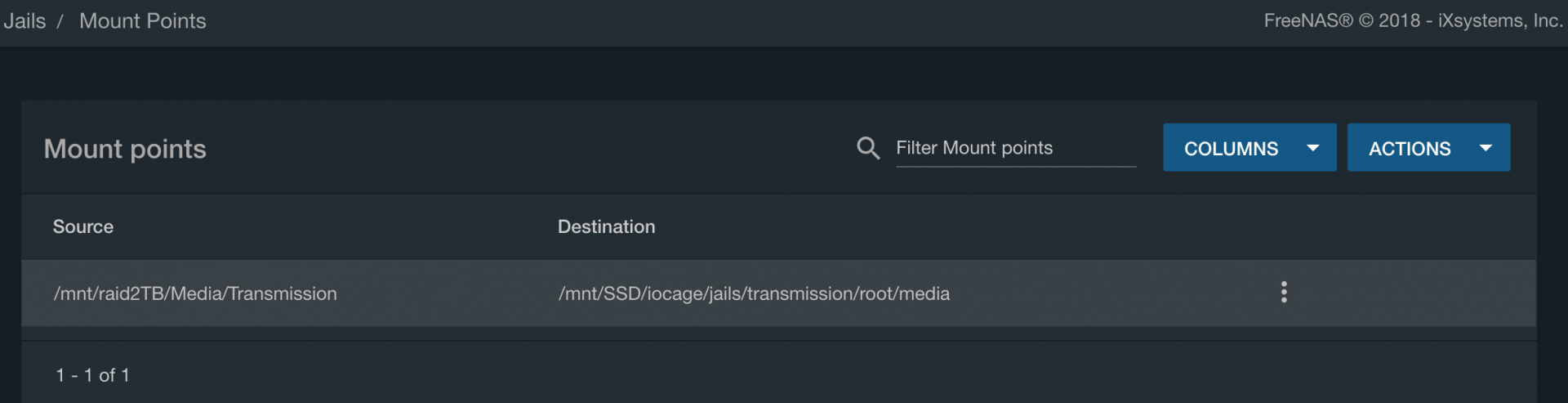

But when Transmission downloads new files just like the one I mentioned above, I can't delete/rename those new files using the same user. Here is the mount point for the transmission:
