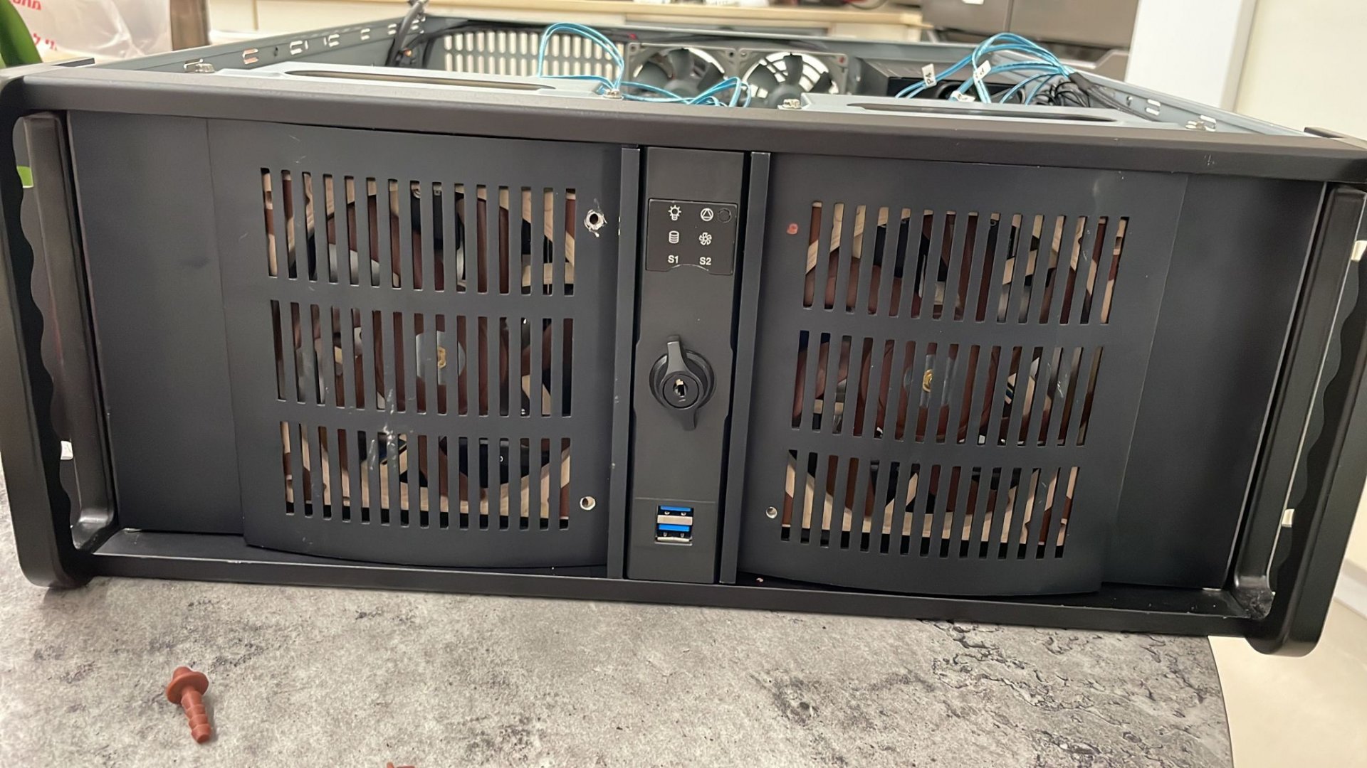

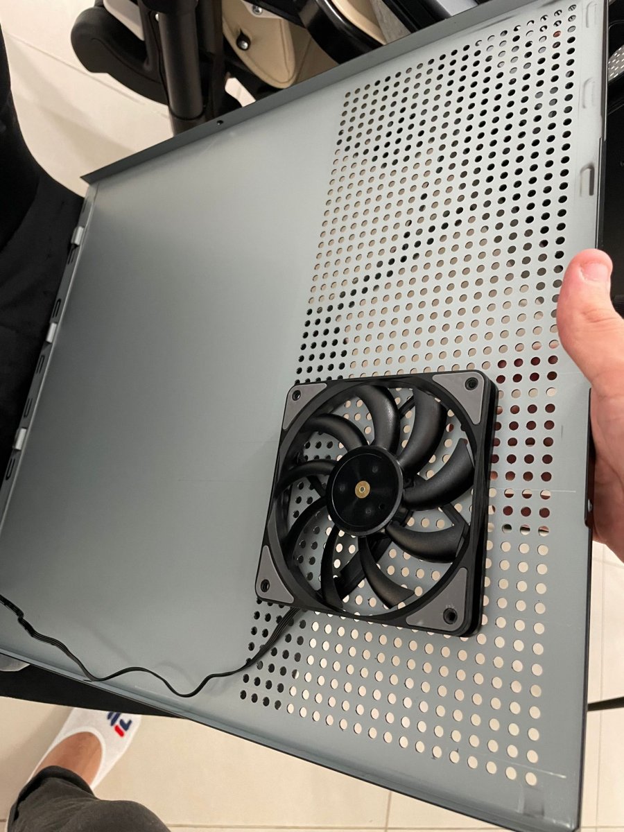

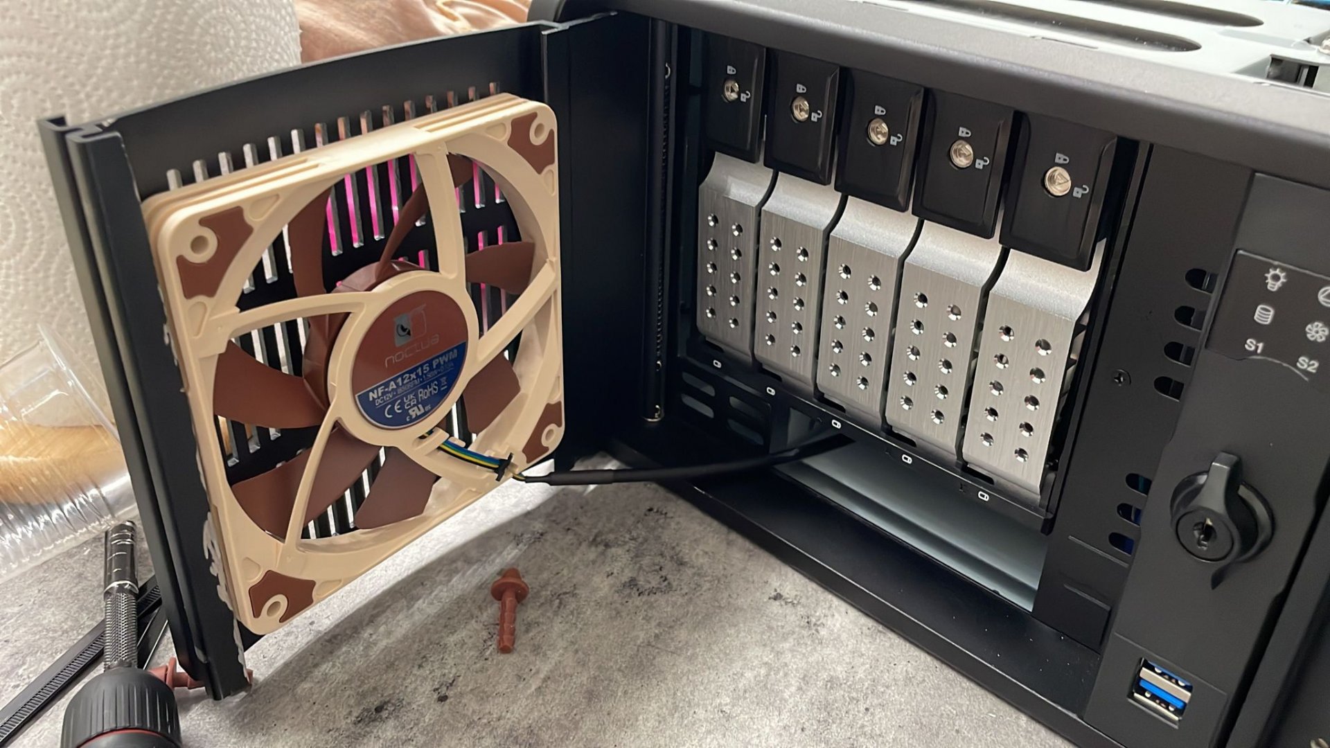

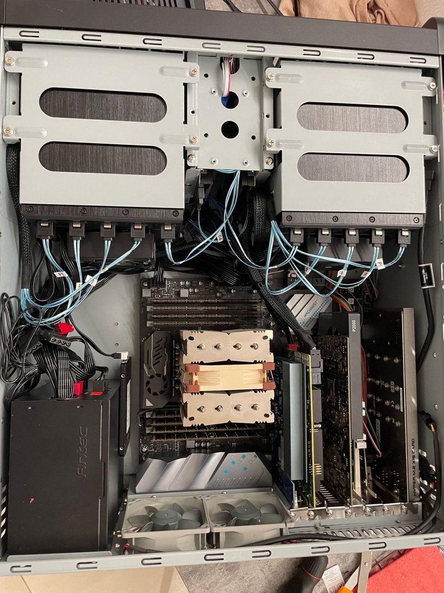

1) the case im useing is the Istarusa D-400 4U case
2) all the drives sit in a BPN-DE350HD drive cages (i have 2 of those 10 total drives)
2.1) i changed the cooling of those which isnt enogh still and i use a fan to help cooling which helps alot and i dont get temp errors enymore
2.2) i have also came up with a permanent solution of this - so no worrys
3) the lsi 16i runs 3 ports and outputs 12 sata ports and 10 of them are connected to the drive cage, also no other drive is connected to this sas controller
lastly, the sas controller runs a little hot but not that much, i will add a noctua fan to it in order to maintain it cooler
thanks for your help!

Comments: The case in question is designed for less drives than you have so you are pushing more heat in than the case is potentially designed for. Most large rack mounted cases have a somewhat noisy fanwall across the case that pulls air through the drives and through the case. You do not have a fan wall so probably have insufficient air through the case. I note that you have added anther fan and don't get temp warnings any more - but you may still be short on airflow.

regarding the case has more heat or disks then it should - i know but i do what i can in order to keep it cool, and i made some mods to the case and the hdd bays in order to do so and it is working fine
i will add an active fan to the sas controller in order to keep it as cool as possible (saw that its common to do so)

OK - that is a metadata error, usually meaning you have to destroy the pool and start again. However in this case simply deleting the HDD_Pool/downloads/qbit - or maybe the whole downloads dataset may fix that issue.
Lets look at what the common parts are that are causing the issue:
Motherboard - no reason to think thats an issue
LSI Card - for the moment I don't think thats the issue - but more cooling is good
SAS / SATA breakout cable. The issue is across 2 of them, but not all ports - so I don't think thats it
So we are down to the BPN-DE350HD.
Is the following possible?
1. Power down
2. Remove all disks from the effected BPN-DE350HD
3. Attach the disks via the SAS/SATA breakout cable and SATA power connectors, direct to the PSU , each on their own power connector
4. Put the disks on top of the case
5. Get a big fan (house style) and point it at the disks - so they get some airflow
6. Power Up
7. Make sure the pool has appeared
8. Zpool clear & scrub
See what happens
Question - what PSU do you have?
My current thought (educated guess) is that 2 SATA power connectors to 5 3.5" HDD's is borderline not enough (those connectors are not nearly as good as molex) - so an issue inside the cage MIGHT be causing the problem - so eliminate the cage and test.

gilgedje
Jun 14, 2023
14
Some pics for referance
i used 12x15 noctua fans in front and moded the panel a bit for them to fit adding holes in the process
and another fan where the pcie lans are to remove heat better
also switched the cages fans with larger noctua fans
