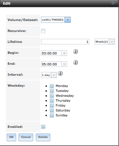

I am running the latest version of FreeNAS and have setup a periodic snapshot of a dataset, however, it does not appear to be happening. When I click on the snapshots tab there is nothing listed. I have attached a screen shot of the snapshot settings.
I was expecting it to take one snapshot a day at 3am and then keep it for a week. What am I doing wrong?

Your settings look fine but can you give us a more detailed explanation about any error messages you see?

Good find, thanks. This does sound like the issue I am experiencing. I have not had any snapshots configured prior to 9.10.2 so I can not verify that they were working before the update but, they are not working on 9.10.2.
Vaibhav Chauhan said "... have reverted 79bd0e586281a7fbb1f0f6b95e4ddbd39a94cf5e which should fix the issue." He also has changed the status to "Ready for Release". Does anyone have an idea of when this update may be released?

Not all users that have automatic snapshots configured in 9.10.2 are affected. It seems to depend on the schedule itself if snapshots are executed delayed or not at all. On my system, all snapshots and replications are executed 31min late, which isn't troublesome for me (6:31/12:31/18:31 instead of 6:00/12:00/18:00).
Some of my snapshot configuration details:
Begin: 06:00:00
End: 23:00:00
Interval: 6 hours

9.10.2-U1 has now been released. I have just updated and created a test periodic snapshot, it worked as expected. I appears that this bug has been resolved in 9.10.2-U1.
