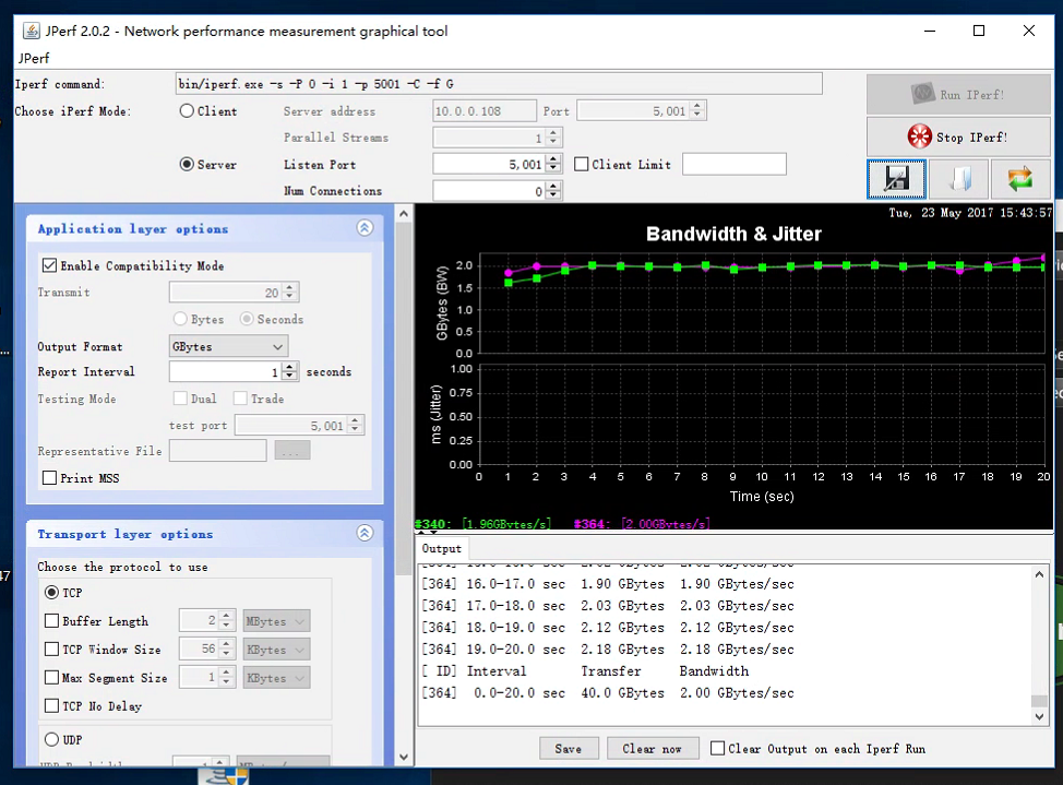

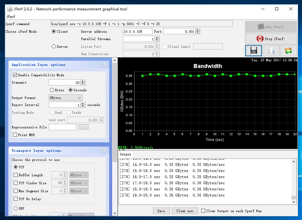

What sort of performance do you see when using iperf between the two machines?
There will obviously be a need for tuning the system to work with 40GbE. There are plenty of examples of 10GbE tuning on the forum.
This kind of slow :(
also I change the default settings in windows10 is:
mtu 9014
transfer and receive buffers to max
modify the hosts file to: (local ip address) (machine name in the network) like : 10.0.0.109 test (server is 10.0.0.108). For this setting can get big rise up for 10GbE windows performance.

SweetAndLow
Sweet'NASty
Nov 6, 2013
6,421
Test going both directions?

skyyxy
Jul 16, 2016
136
Transfer back is fast between 1.8x-2.1GB/S,(I just have 10hdds at now, because no money :( ), this looking like normal for 10hdds with sas3.0 level.

SweetAndLow
Sweet'NASty
Nov 6, 2013
6,421
HDDs have nothing to do with iperf results. 10hdd will only give you maybe 10gbps anyways.
So the results are different going either direction. This could be a problem on the client than. Basically there is a problem on both sides because your speeds are still slow.

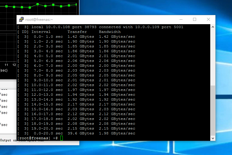

skyyxy
Jul 16, 2016
136
Ok you're not going to get good help. You clearly posted 300MB/s writes and .3 GB/s one direction and 2GB/s the other. But you're saying they are the same. Good luck with your insane project, I suggest hiring someone who knows what they are doing.
I'm not crezy. but its real. look the attachment. now its really both way 1.8-2G/S.
