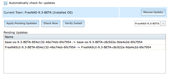

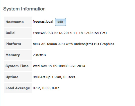

I have been trying to apply the updates shown below and get the error installing updates, no additional details.

The error was just the green pop up box at the top, no additional details. I had rebooted the server but noticed on the boot list that there was an additional item so I rebooted again and that seemed to solve the problem as the updates were installed and no longer listed as pending.
