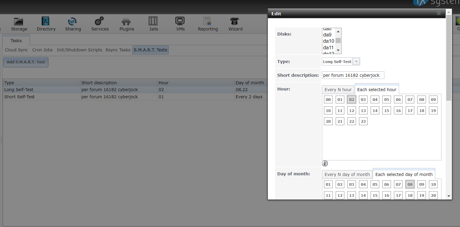

15,504
Well, the SMART data shows a history of an error with the disk, but that's several thousand hours ago. Nothing appears to be problematic with the current status. However, there are a few matters of concern:
  • The last scheduled SMART test was 34000 hours of runtime ago--you should be running regular tests. I like a short test daily and a long test weekly, but that can be somewhat flexible.
  • At nearly 46000 hours of runtime, you should probably consider the disk to be fully depreciated. It doesn't necessarily need to be proactively replaced, but be wary.
  • You're using the shell through the web GUI, which is truly awful. An SSH connection will give you a much smoother experience (relevant to the immediate discussion, it will give you a scrollback buffer, so you don't need to pipe the smartctl output through more)
esamett
May 28, 2011
345
Thanks. I've never been successful getting SSH connection to work (bear of little brain)
I thought I had smart testing set up. Please help me figure out what I am doing wrong.
15,504
You need to highlight every disk you want to be tested on the schedule.
esamett
May 28, 2011
345
Laughing out loud... I thought I was clever and safe. Thank you my friend.
