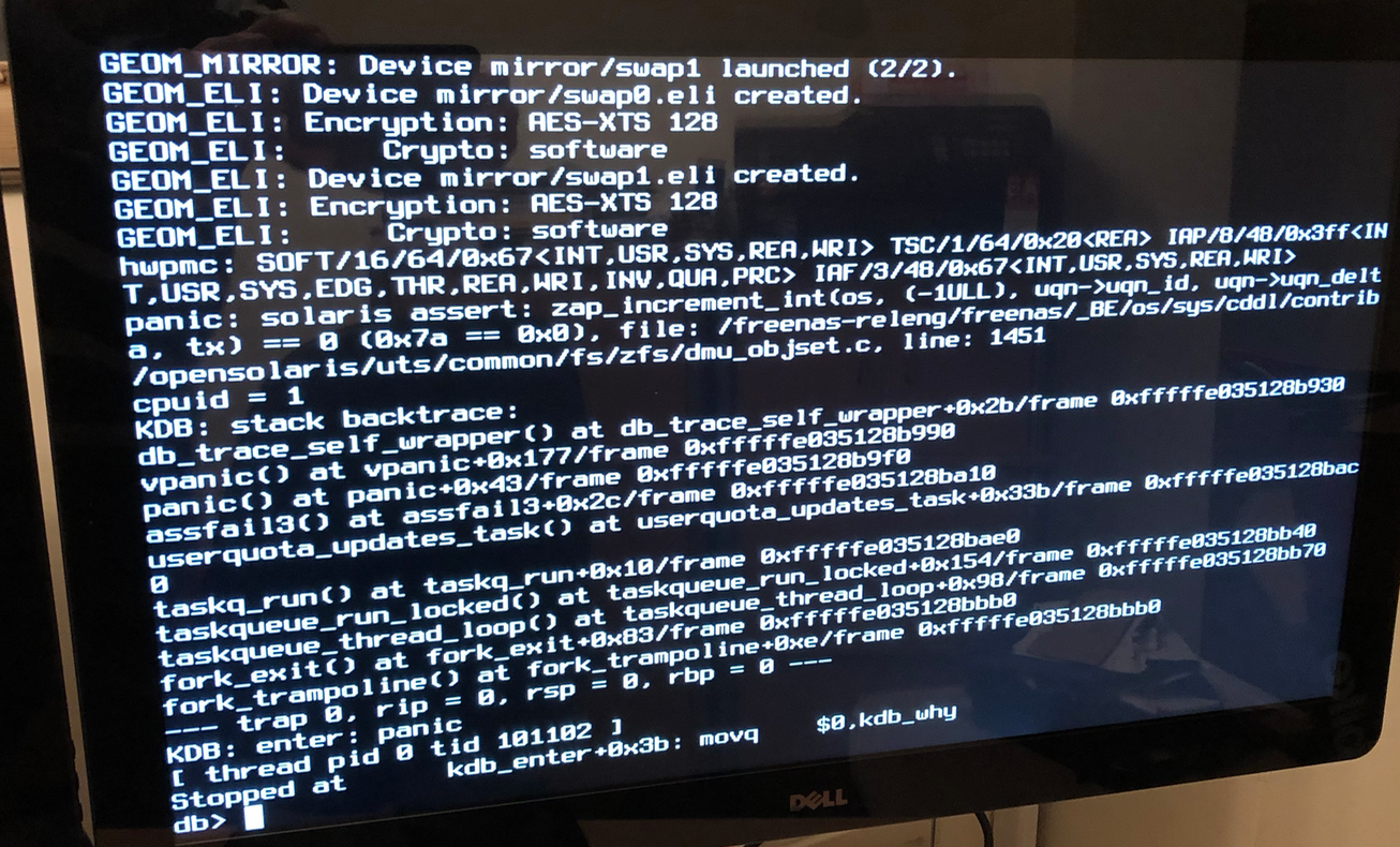

However recently it has developed an error when it panics and drops into the debugger just as the data pool is being mounted on boot.
I get exactly the same message each time.

I have tried removing one disk at a time and the error continues to occur on reboot until there is either no disks or just one disk left.
It may not be the wisest move, but in frustration I booted without the disks and added them in one at a time. The disks were recognised and appeared in the list of disks in the GUI, but the data pool didn't come up (not a surprise) and any attempt to import the data pool fails to provide any disks to select from.

I'd suspect a bad boot device and would reinstall to that SSD. If you don't have a config backup you'll have to set everything back up again, but the pool should import.

Oh I see, this is the data pool causing this. I'd probably Google some of those error messages but I'm wondering if your pool is corrupted. I hope you have backups.

After booting and getting the configuration restored (I had a backup), exactly the same error occurs when booting from the SSD.
I didn't have a backup, just didn't get round to it...
Is it worth trying anything else before I trash the disks and rebuild the ZFS data pool?

I have given up and have rebuilt the data volume now with the SSD as my boot device.
I realised tvat having all four disks in the pool as two vDevs of two disks protected me from a couple of disk failures but not from a corruption of the pool or just one of the vDevs.
I am now experimenting with two pools each with a single vDev of two disks as a mirror pair. I am going to set up a replication task from the FreeNas server to itself with the second pool as the target.

Ahh well, I'd probably Google that panic message a bit but I suspect you're probably going to have to wipe it and start over.
