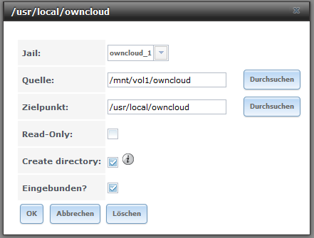

Hello,
Since I am a absolute Linux Newbie I tried to install Owncloud through the GUI. It worked and the jail seems also to work fine. The only "small" problem is that the Owncloud plugin won't start.
I guess it's maye because of the added storage and some permission problems maybe?
How can I find out why the service won't start?
Best regards
Andy
