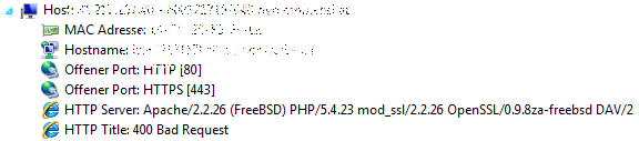

This is what a portsniffer says if I enter my dynDNS adress
P.S.: For the moment I opened 80 and 443 but I just want to keep 443 open for https
