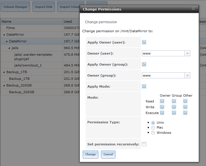

Then I used the freeNAS GUI to change permissions for both my datavolume and the owncloud_1 jail. For both I've set the owner(user) to the built-in www account.
However when opening a file from within owncloud, it is still read-only.
What can I be doing wrong? Should I set the recursive checkbox?

dont do that, you are about the break your jails. never change permission on your jail datasets, those are operating system files that will not work properly if they are modified.
what dataset contains the files you are sharing? and dont say a folder in your jail... you should make dataset(s) for you share that you mount into your jail.

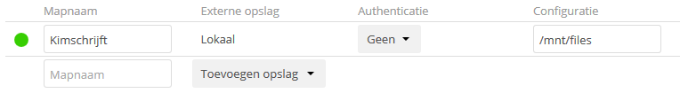

I can't make it work. I started from scratch (uninstalled and reinstalled the owncloud plugin).
1. I added storage into the owncloud jail (/mnt/files)
2. I used the external storage support app to mount my dataset into this directory.

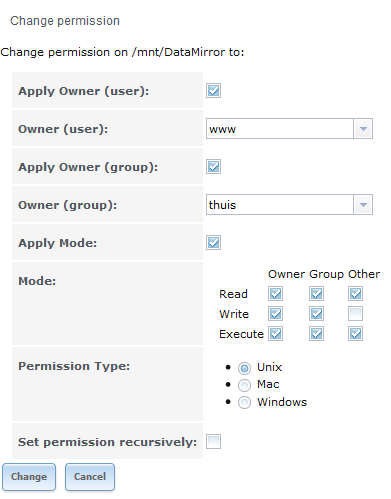

3. For the permissions :
- I am sharing the a directory on the dataset via CIFS/SMB, so that the Windows user can map a network drive to this share.
In order that they do not need to log in, I created for every Windows-user, a FreeNAS user with the same accountname and password.
I've put all these FreeNAS-users in a new FreeNAS group called (called 'thuis') and made this group the group owner of the dataset.
- I've made the existing www user the owner of the dataset, and added www also to the 'thuis'-group.
- So Now I can see my files from within owncloud, but they are still read-only.

If you read the FACTS section of the thread I linked, it states that permissions for the plugin process are governed according to the jail's user/group mapping.
In the owncloud_1 jail, the www user must be in a group with a GID matching the "thuis" group.
See 'Solution 3'
EDIT
The above is if you want to use group permissions. But now that I look at your permission settings, the www user should have user permissions to write to those files.

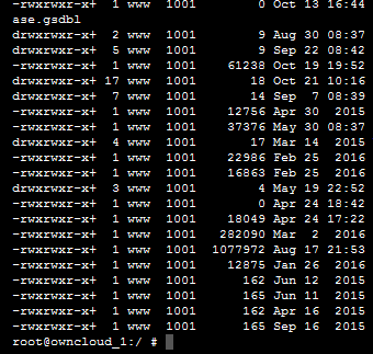

Can you should the output of the following run in the owncloud_1 jail.
ls -l /mnt/files

Joshua Parker Ruehlig
Dec 5, 2011
5,949
according to Unix permissions those files are writable by the www user, but you have widows ACLs enabled on the files (see the +). that is likely adding more requirements to writing to the files. I dont know anything about windows ACLs, goodluck.

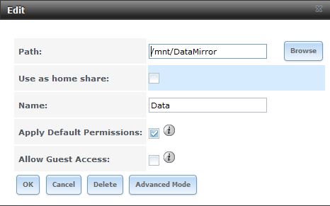

I was able to delete the ACLs using this command :
find /directory/with/your/files -exec setfacl -b {} \;
This resulted in no more + characters in the permissions column.
However this also resulted in read-only access on my SMB-shared Dataset.
Then I was able to fix this by enabling the 'Apply Default permissions' checkbox on my SMB-share.
And this resulted back in the ACLs (+ characters).
Can you please advise? I think I should be able to have write permissions without applying the Windows default ACLs?
Dec 5, 2011
5,949
im not experienced at all how windows ACLs work. what I have implemented in the past for other peoples networks is adding 'force user = USER' to the auxiliary parameters of a CIFS share.
this allows writing but doesn't provide authentication, though I believe you could do that at the CIFS level.
