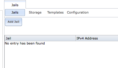

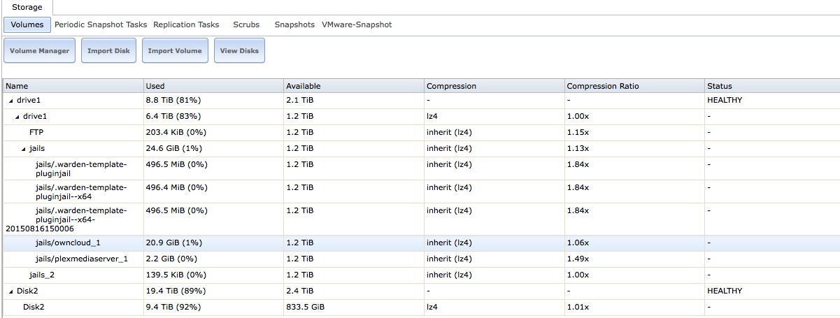

But! I have a lot of Data in a Owncloud Jail. If I go to storage I can see the Jail listed along with my drives, the jail consumes 20.9gb. The Jail only appears in storage, it does not appear in the list of jails. I tried to re-install the owncloud plugin but it just created a new jail, which was visible in the Jails listing which was empty, I deleted it, I also have a jail for plex. It shows up in the storage and I am able to navigate to it in finder and see the listed files under media. But in the owncloud jail, the media folder is empty, and I am unable to locate any data within the jail, although as I said the jail is 22gb in size.
I want to retrieve the data from this jail, if anyone could point me in the right direction please, where are the files hidden. I have attached a couple of screen shots to clarify.

Set your jail root and your jail's will be listed where you can start them.

You must hate noobs, but how exactly can I set my jail root. I have looked through the manual and can not see how to do this.

Jails tab -> configuration -> jail root.

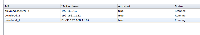

Thank you Jailer and m0nkey.
the jail is now showing up in the jails tab.
But I am still not closer to rescuing my data. I can browse to the media folder in the jail, but I do not have access to it, there is a small no entry sign on the folder, when I try to check the size it shows as zero bytes.
I have been searching the internet for days trying to find an answer before I came here> I have been around windows and apple computers for many years, but linux is new to me. None of my DOS does many any good now. I really need a good nudge in the right direction please. I tried reinstalling the owncloud plugin but it just created a brand new jail.

Thank you.
I have solved my problem, by downloading the ownclound plugin and then uploading to the jail.
Thank you Jailer and m0nkey for your help.
