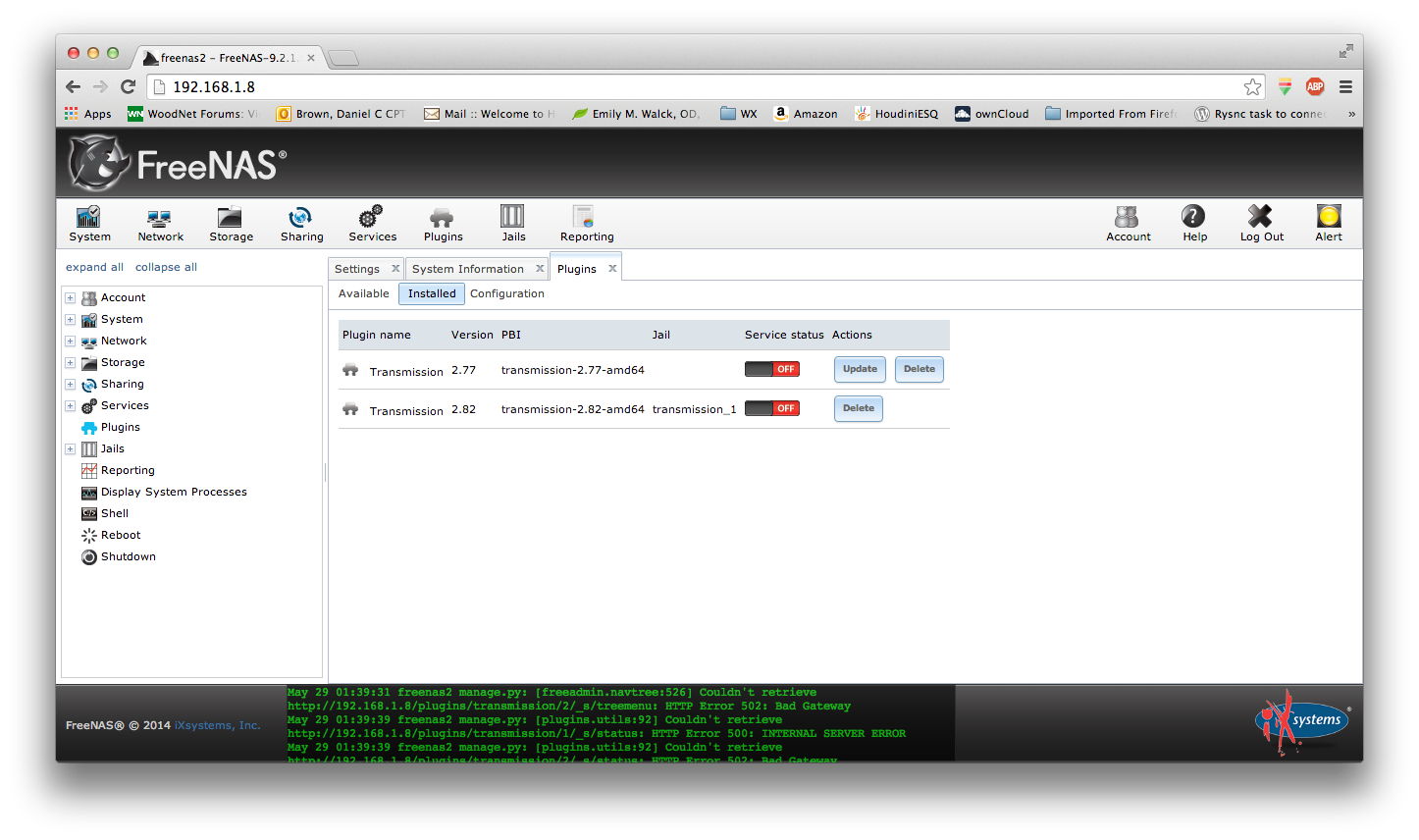

The rm succeeded--the directory /mnt/zfs1/jail/transmission has been removed. However, the plugin is still listed as installed (see attached).

Was there an associated /mnt/$vol/jails/.transmission_xxx.meta and was that file removed?

No resolution. It appears to be only a cosmetic issue, so I'm not too bothered by it, but it seems there ought to be a way to clean up that list when it gets out of sync with reality.
