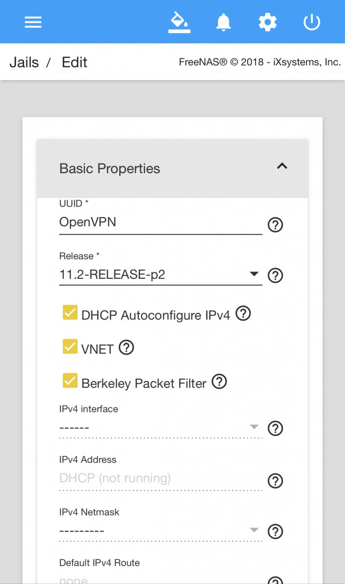

m0nkey_ I am pretty sure I have it configured that way:
However I am getting the issue where the tun interface cannot be accessed/initialized, and my understanding is this is because the devfs is not being mounted properly in iocage jails starting in 11.2 Beta3 or RC1.
