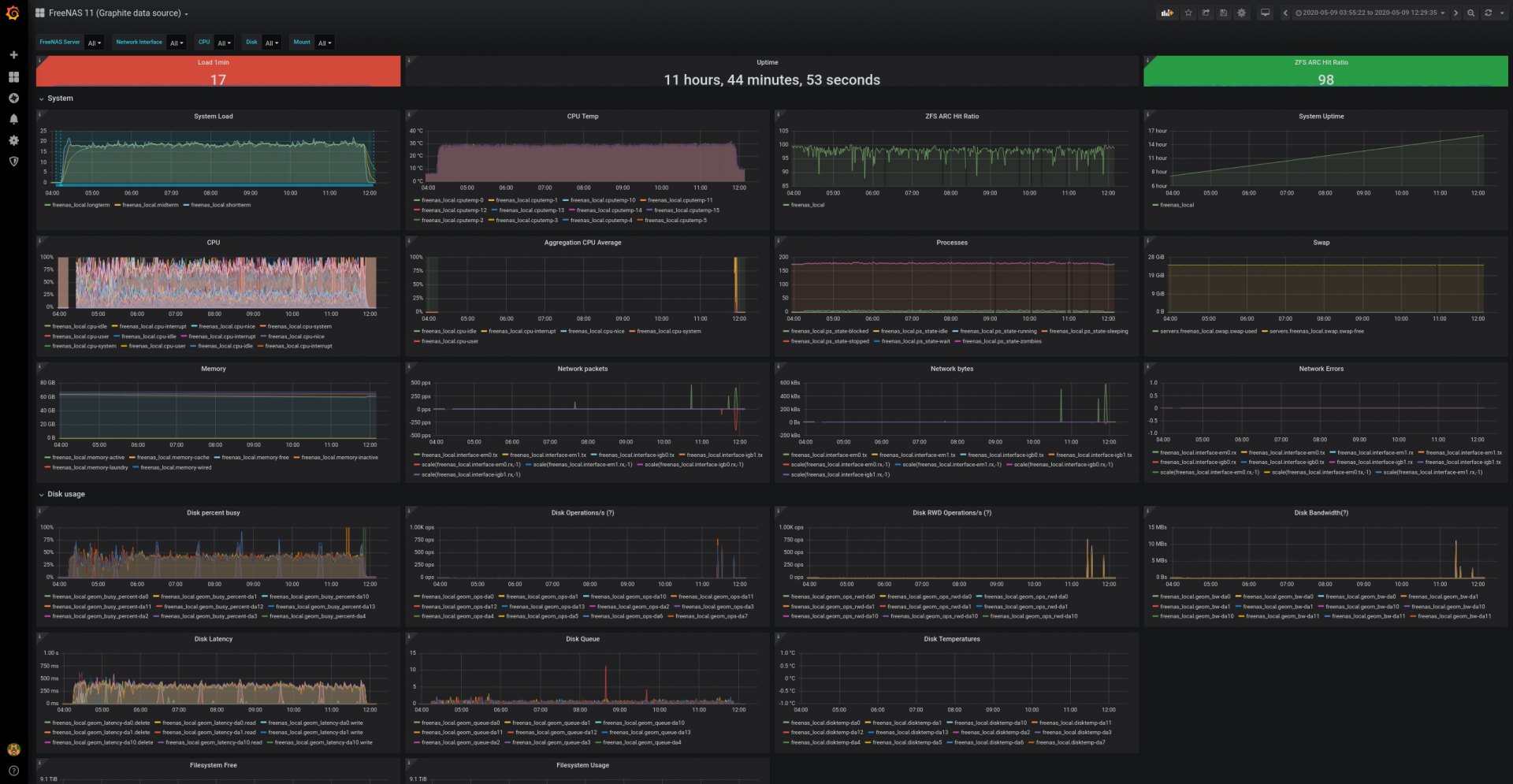

Just last night it happened again while I was asleep. I woke up to find it in the problematic state. I was poking around trying to get more information while it was happening (not very successful, I'm normally a Linux admin guy and FreeBSD is proving to really test what I can do with limited tools I'm used to, but that's a learning problem). Suddenly I noticed the problem stopped. I double checked my graphite/graphana server (which I stood up to specifically figure this out), and all the metrics that weren't getting saved off, were now there. Here is what metrics I have over the 8 hour period that collectd, python3.7, and rrdcached were working hard in some mine and I don't even know why.
Unfortunately, when I opened the UI after this happened, it happened yet again, and the UI has yet to return. I suspect that it will take another 8 hours to return unless I force a reboot. UI seems fine if I get in and out quick enough. Otherwise CMD line is my only way to do anything. Any help would be greatly appreciated.

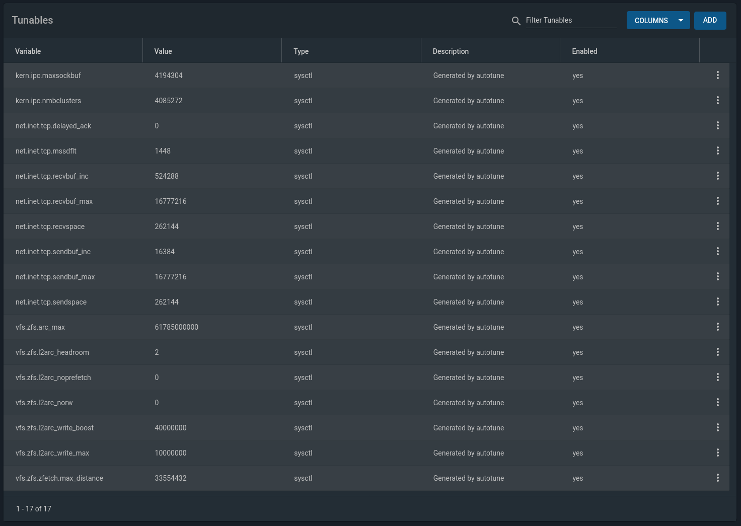

On https://github.com/Cacti/rrdproxy/issues/3, I found a suggestion that rrdtool may be hitting a socket too frequently, and tripping the OS's SYN flood protection. This causes a wait state leading to the high CPU.
One thing to try is to enable autotune in System->Advanced, and then reboot. This will set various sysctls under System->Tunables that may help mitigate this issue.

I enabled autotune and the system setup the following settings:
I have noticed with the autotune set tunables the web UI isn't as snappy, but I can live with that if it means my server doesn't eat itself alive ;)
And now I wait. I'll let it sit for a couple of hours and try hitting the web ui (as that tends to trigger the problem more often than not) every so often. I'll also keep an eye on metrics and see if it triggers again. Fingers crossed it doesn't.
I'll let this run for the rest of the day with these and will report back what happens.

Dewey
Dec 19, 2016
14
Is Graphite running on FreeNAS? I enabled reporting to a Graphite server because of the high load and cpu problem to being with. That way I could look at metrics without being dependent on a UI that was unresponsive with the rest of the box.
