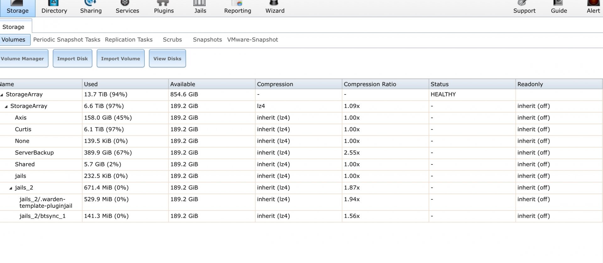

Hi, I am new on the forums, but I have been using Freenas for a few years. Today my problem is: i have attached a screenshot showing I have 13.7TiB storage and it is all used up with 6.6TiB used. I have 4x 4TB drives installed, so i should about 13.7 usable space. can someone tell me what my problem is by looking at the picture? Am I missing something, or do you need more info to help me?
Thanks for any response

Do you use snapshots?

It's likely your snapshots.

the snapshots tab shows it is using under a mb combined.
Hmmm... post the results of this command (in CODE tags, please):
zfs list -o name,used,refer,usedsnap,avail,mountpoint -d 1

Hi, here are the results:
[root@CurtisNas ~]# zpool status
  pool: StorageArray
state: ONLINE
  scan: scrub repaired 0 in 19h43m with 0 errors on Sun Aug 21 19:43:23 2016
config:
        StorageArray                                    ONLINE       0     0     0
          raidz2-0                                      ONLINE       0     0     0
            gptid/5d0ab2f8-2771-11e6-8205-78e7d17c180a  ONLINE       0     0     0
            gptid/db7e9fa8-1206-11e6-beb1-78e7d17c180a  ONLINE       0     0     0
            gptid/dc56b891-1206-11e6-beb1-78e7d17c180a  ONLINE       0     0     0
            gptid/16e6ddcb-1616-11e6-8a51-78e7d17c180a  ONLINE       0     0     0
errors: No known data errors
  pool: freenas-boot
state: ONLINE
  scan: scrub repaired 0 in 0h0m with 0 errors on Sat Aug 20 03:45:40 2016
config:
        freenas-boot  ONLINE       0     0     0
          da4p2     ONLINE       0     0     0
[root@CurtisNas ~]# zpool list
NAME           SIZE  ALLOC   FREE  EXPANDSZ   FRAG    CAP  DEDUP  HEALTH  ALTROOT
StorageArray  14.5T  13.7T   856G         -    38%    94%  1.00x  ONLINE  /mnt
freenas-boot  29.8G   517M  29.2G         -      -     1%  1.00x  ONLINE  -
[root@CurtisNas ~]# zfs list -o name,used,refer,usedsnap,avail,mountpoint -d 1
NAME                        USED  REFER  USEDSNAP  AVAIL  MOUNTPOINT
StorageArray               6.62T   163K      250K   190G  /mnt/StorageArray
StorageArray/.system       76.4M   151K      198K   190G  legacy
StorageArray/Axis           157G   157G         0   190G  /mnt/StorageArray/Axis
StorageArray/Curtis        6.08T  6.08T         0   190G  /mnt/StorageArray/Curtis
StorageArray/None           140K   140K         0   190G  /mnt/StorageArray/None
StorageArray/ServerBackup   390G   390G         0   190G  /mnt/StorageArray/ServerBackup
StorageArray/Shared        5.70G  5.70G      209K   190G  /mnt/StorageArray/Shared
StorageArray/jails          232K   140K       93K   190G  /mnt/StorageArray/jails
StorageArray/jails_2        671M   174K         0   190G  /mnt/StorageArray/jails_2
freenas-boot                517M    31K         0  28.3G  none
freenas-boot/ROOT           510M    25K         0  28.3G  none
freenas-boot/grub          6.33M  6.33M        1K  28.3G  legacy
crwoo
Aug 26, 2016
14
I deleted all my snapshots and it didn't make any difference. they showed usage under a mb, but I dont use them so I deleted them.
crwoo
Aug 26, 2016
14
I had two disks fail on me in the past, but i used replace and they resilvered fine. I do not think that is the problem, but i thought i'll throw that out to you. The reason I do not think that is the problem is it shows 13TiB at array size and only 800gb remaining.

Strange, and puzzling... have you recently created large filesets or in some other way come close to filling up your pool, then deleted the files?
Also, it may help us if you'll post your system information, per the forum rules.
Have you tried rebooting the server? (Hey! It works for Windoze!) ;)
crwoo
Aug 26, 2016
14
Recently i made an iscsi block, but deleted it. Could the files still be somewhere? That could be huge.
I have a HP 380g6 server with 32gb ram and a jbod raid controller. Do you want more specific info?

It's possible the space for that iSCSI block is still tied up... for some reason. I've never seen this myself, but I've read about others experiencing that kind of problem.
Seriously, try rebooting the server.

The top line under Storage is the total raw capacity of your disks. The second line is the usable capacity of your pool after taking RAID and some other things into consideration. Because you have a RAIDZ2, you only get about 2 drives worth of space, so 6.6 TB sounds correct.

4x4TB in RaidZ2, ~7TiB usable sounds sensible, rest is parity.

I didnt realize that i dont even get half. I thought it's like raid5. Is this the best way to setup the nas? If it is then i guess i will have to add some disks.
This post by Cyberjock explains how many parts of ZFS work: https://forums.freenas.org/index.ph...ning-vdev-zpool-zil-and-l2arc-for-noobs.7775/
Doooh! That'll teach me not to ask for system info! Thanks for setting us straight! :confused:
Sorry, @crwoo, but your pool is just full...

@Spearfoot what do you mean with the first part? Was it sarcastic? I can post system info if that is important, but i didnt think it is relivent here. I think i probably am using the wrong raid mode.
RAIDZ2 (and RAID6) uses 2 disks for parity where RAIDZ1 (and RAID5) use only one. Yours is a safe configuration: you could have used RAIDZ1, but RAIDZ1/RAID5 is not recommended for 'large' drives such as yours; the chance of losing your entire pool if a drive fails is too great.
You can expand your pool by adding another vdev: ideally an additional 4 drives matching the ones you have. Alternatively, but less optimally, you could add a pair of drives in a mirrored vdev.
EDIT: Here's another alternative -- but you must have a good backup of your system to do it!
  • Buy two more 4TB disks.
  • Destroy your existing pool and create a new RAIDZ2 pool with 6 x 4TB disks.
  • Restore your data from backup.
This would give you twice the storage space you have now, at the cost of only two more drives.
Good luck!
