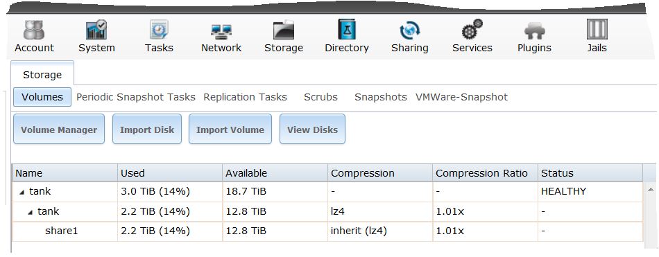

Referring to Norlig's question "Is my available space correct" may I also ask?.
My setup is with 8x3Tb WesternDigital Red HDDs and FreeNas-9.3 in raidz2, then have I lost 3TB?...see screen shot...Sorry for any formatting errors.

No, not really, you get around 2.6-2.7 TiB out of a 3TB HDD, and since you have six data and two parity, 6 * 2.6 = 15.6TiB. The system is reporting 2.2TiB used and 12.8TiB available, which strikes me as around 15TiB, so you might be short 0.6 TiB, but that's just as likely to be metadata and suboptimal block allocation issues.

You should have around 16 TiB and you have 2.2 + 12.8 = 15 TB so it's about right if you take into account the metadata and misalignment overheads.

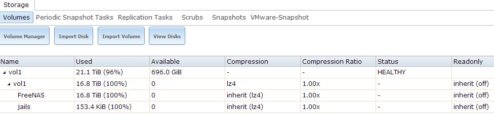

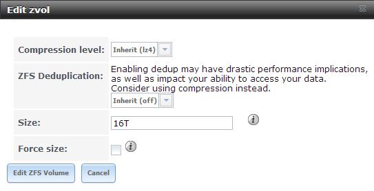

I'm referring to the zvol named FreeNAS on the attached webgui snippet.
My interpretation of what I did was to create a single volume that would allow full utilization of the 6 4TB hard disks (I created a RAIDZ1 and assumed I'd have 20TB available total space available). I assumed I'd have somewhere around 20TeraBytes of space to present as an iSCSI target. When I did and very shortly after I started to copy data to the share; I was receiving webgui alerts that the capacity for the volume "vol1" is currently at 82%, while the recommended value is below 80%. I found this puzzling but assumed that since I had created block storage, freenas was seeing the entirety of my iSCSI as a single block file using 82% of 20TB as I had specified the size to 16T (perhaps this is my error).
Here's a CLI output that doesn't make much sense either...
It doesn't even list the vol1/freeNAS mount where as it did on Monday. And to clarify, the only Windows server that has access to this iSCSI share thinks it is only 50% utilized, it was nearly 75% but I had deleted files off thinking it would shrink the usage in FreeNAS. I believe that to be wrong thinking.

Your assumption was incorrect. ZFS is a copy-on-write filesystem, and "using it all" is never wise with a CoW filesystem, and with ZFS it isn't even really possible. ZFS is unable to find any suitable blocks for allocation and so writes are failing.
A pool hosting iSCSI zvols or other block storage-like abstractions should be built out of mirrors and should never pass about 50% capacity if you want some moderate level of performance, and should never pass around 60% capacity unless you know why you may safely break that rule.

Oh and the other half of this, I kinda failed to answer. So you got a five gallon gasoline can, and painted "SIX GALLONS" on it because you thought it looked like it should hold six. You went to the gas station and put the pump nozzle in, which promptly shut off around 4.5 gallons. You maybe then proceeded to top it off 'til the gas was right up to the fill opening and the stupid gas pump still only reads 5.3 gallons.
You've tried to store too much in your pool. Those df's and all that all say zero free because it is painfully full to the point where it might not even be possible to fix it. You created a "16TB" zvol for iSCSI on a filesystem that only had maybe 16.8TiB of space and it's full way past the danger point.
Now the thing is, Windows has no way of knowing how full the ZFS pool is. You've told Windows that it has "16TB" of block storage. It is telling you that there was 75% utilization and now there's 50% utilization, but the way that Windows "deletes" files is to merely make a little note that such-and-so block is now an available free block. The data on that block doesn't actually get nuked (this is actually not always true, since you can set Windows to use TRIM/UNMAP), so ZFS is still dutifully storing that "freed" data. This is the nature of virtual storage. Unless/until something makes ZFS aware that the block is no longer in use, either by zero-filling the block or by sending a TRIM/UNMAP command for the block, ZFS will continue to store that data.
PLEASE go read https://technet.microsoft.com/en-us/magazine/2009.08.utilityspotlight.aspx
Now, after having deleted those files, had you maybe run something like "sdelete -z X:", that would have zeroed all the unused space on X:, and ZFS would have compressed those zero-fill blocks. This isn't actually a true or complete fix, just a remediation.
