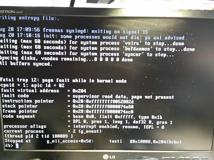

After I noticed the error, I detached the backup for safekeeping and stopped the scrub with zpool scrub -s TANK
The system is sitting idle with the power still on and a console shell open so as not to destroy any information. Anything else I should check?
How can I determine why the drive became detached?

I shut down and the shutdown process hung:
Fatal trap 12: page fault while in kernel mode
cpuid =1; apic id = 02
fault virtual address = 0x204
fault code			   = supervisor read data, page not present
index.php
I suspect this was caused by the loss of the swap area on /dev/ada0.

UPDATE: After restarting the system, I noticed that the system cleared the error without my intervention.
zpool status TANK
  pool: TANK
state: ONLINE
  scan: scrub canceled on Sun Aug 20 02:49:20 2017
config:
		NAME											STATE	 READ WRITE CKSUM
		TANK											ONLINE	   0	 0	 0
		  raidz2-0									  ONLINE	   0	 0	 0
			gptid/73fc17c0-1916-11e5-b2b5-c860006d863b  ONLINE	   0	 0	 0
			gptid/bcd021f7-dbd8-11e4-adc9-c860006d863b  ONLINE	   0	 0	 0
			gptid/fcd3d3cb-f747-11e4-95cc-c860006d863b  ONLINE	   0	 0	 0
			gptid/76e6e5f1-0f39-11e5-8bc3-c860006d863b  ONLINE	   0	 0	 0
errors: No known data errors

I just started a scrub so we'll see what happens.
Given the smart data is OK, is it possible the issue is the cabling or the controller on the motherboard?
If so is there any way to determine the cause with certainty?
I'm also wondering if the problem could have been caused by a crash?
As I recall a crashed SAMBA connection caused FreeNAS to hang so that I had to reset it.
Assuming the scrub passes what should I do going forward?
