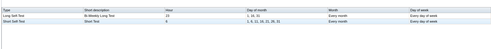

I don't understand why its doing the short test every hour... What did I misconfigure?
From what is shown there, I don't see the problem.
How do you have this screen configured?
Donny Davis
Jul 31, 2015
139

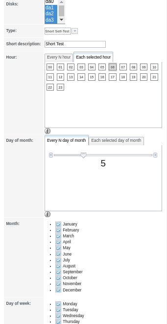

They are configured to run every day of the week, and from how I thought it would run at 0600 every 5 days.. I must have something misconfigured, because I can surely see every disk is being smart tested every hour.
That schedule actually looks fine. Is it possible that you changed this setting through the API?
