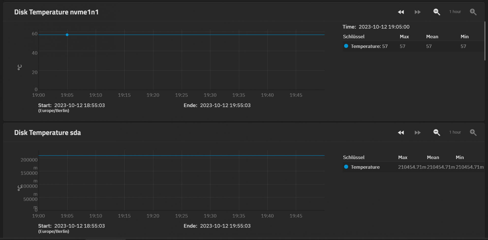

Hi folks,
I encounter odd temperature readings from my 4 spinning rust drives:
the two NVMe-Drives are fine, but all four MG10ACA20TE are messed up. Can you give me a slight hint how to fix this?
Thank you in advance for your patience,
Kind regards,
Ralf
Try running update-smart-drivedb, it's possible your disks aren't understood by the relatively old version of the database that ships with TrueNAS.

I will give it a try.
The drives have been running for a while and temperature readings were in adequat measures. The odd behavior appeared a couple days ago.
I am not aware of any changes I made at that time.

Thank you for the feedback, I did not found this notice.
So, I might have to lean back and ignore it for a while.

Patch installing right now ...
