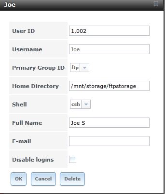

joeschmuck
Old Man
May 28, 2011
10,996
Setting up the FTP is a piece of cake. I just had to read what you desired.
1. Under the Services tab, FTP settings, just set the path to where any anonymous user would end up.
2. Enable the FTP service.
3. You must setup users for every account you want to have access and it's destination. Example:
For the Admin, or your own account enter the path you desire.
Note: All paths must start with "/mnt/" or you will not be able to log in. Remember that /home/user is trying to access the read only boot device (flash drive) and that is why it needs to be on the storage drive "/mnt/"
Let me know if this explains it enough. I'm willing to help if I missed something.
-Mark
