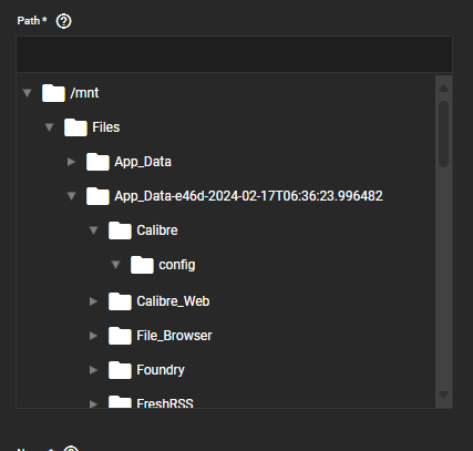

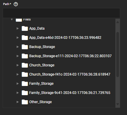

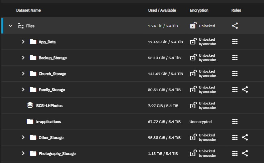

After replication some data between pools I have ended up with a weird situation. When I go to a drop down to select a path anywhere on the UI I see a duplication of the dataset with an added part to the name. These do not appear on the data set part of the UI. I have attached pictures below to show. Is this something I should be worried about and how do I resolve this?

Do they show in the command-line?
zfs list -r -t filesystem -o name Files
finbarlorei
Feb 18, 2024
7
Thanks for the response.
No it just lists the ones in the Dataset image not the additional ones.

It appears that folders were created with an appended timestamp in their names. Not sure why.
Is there any content in these folders?
Is this the source pool or destination pool?

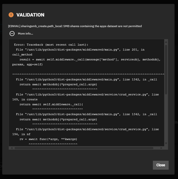

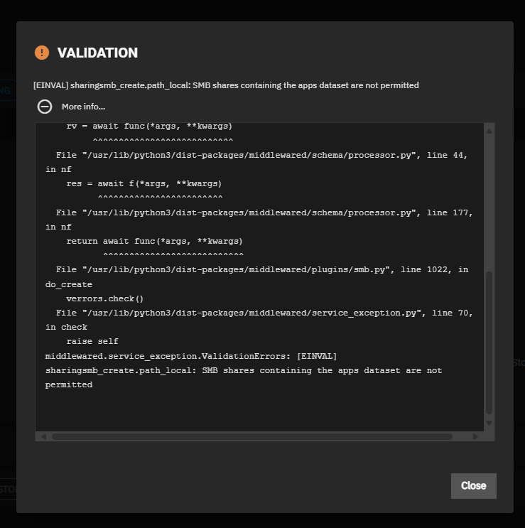

There appears to be additional datasets with in them as in the normal data sets. when I try top add them to an SMB share (for example) I get the following error (pics of full error attached).
[EINVAL] sharingsmb_create.path_local: SMB shares containing the apps dataset are not permitted
When I select the one without the appended part it adds as a SMB share OK and I can access the files.
