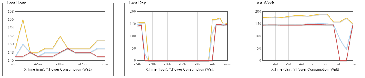

Observationally, my new ESXi VM filer has a fairly flat power utilization;
unfortunately it was down for a downtime much of yesterday and last night but if you look at the "last week" you can see the remarkably flat minimum and average numbers; the higher peak was because I was running a piggy collection script that obviously didn't get restarted after reboot. It doesn't matter if I'm shoving 10Gbps at it or doing nothing, the power utilization is flat. The CPU is a massively oversized-to-the-task E5-1650 v3.
