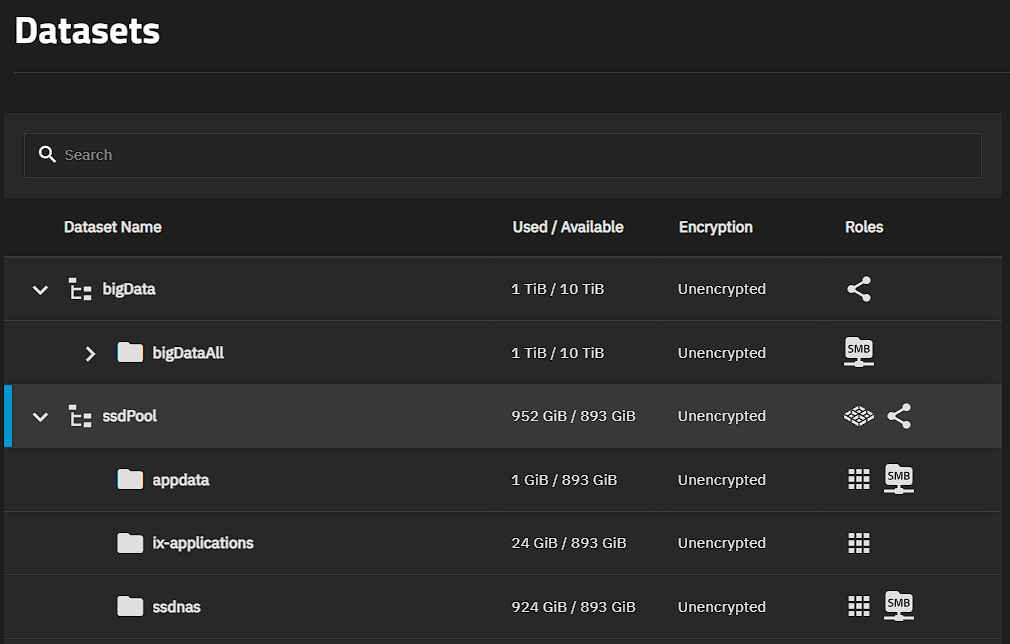

please help me debug this issue:
My ssdPool (which consists only of 1 m.2 nvme SSD) goes periodically offline. It seems that the time it keeps on running OK is random. The SSD goes offline after 2 hours to about 2 days. After this happens, the device cannot be found anywhere - seems like disconnected. Even after reboot it will not appear - I must shut down the NAS completely for a couple of minutes and then it shows up normally like nothing happend.
My pool looks like this - it contains my apps dataset.
My first guess was overheating of the SSD but I ruled that out because adding a cooler and more airflow to the SSD didn't help at all and the temperatures seems fine under 50c all the time.
The SSD doesn't support SMART so I don't know how to debug further.
My plan B is to move everything to the second pool but I'm not sure how hard that would be considering I need to move apps folder and all the permissions as well.
Any advice appreciated. :)

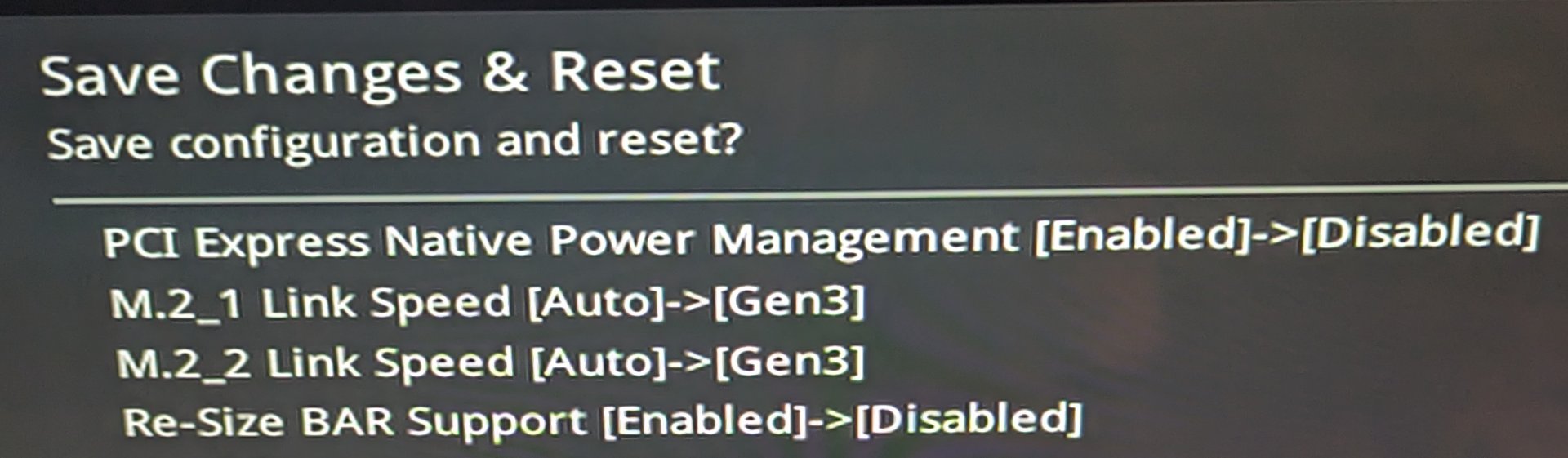

After some more debugging I got it to work :)
It works fine after I changed those settings in BIOS from their defaults:
The most likely one seems to be the power management.
I have a ASUS board and 12th gen i3 so this information might be usefull for others.
