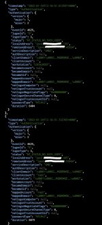

Try running command midclt call smb.status AUTH_LOG | jq and post an entry from where shield is failing.
bacardi8
Oct 19, 2021
85
Hope I do this correct,
this is how it looks.

Client == nvidia shield based on earlier conversation (assuming the IP address that's blanked-out in above log is the nvidia device). It's passing the wrong credentials (something you input into that device).

The blanked out local address is the truenas scale server, the blanket out remote address is the Nvidia Shield.
hmmm....maybe from when I tried to manually entering the connection suggested earlier.
But if I let the Nvidia do it automatically it only ask about my server login details, nothing else.
To login to my truenas scale server I use "root" as username and then my password, and these details I also provided the Nvidia,
so maybe that's where the "root" account comes in and also the issue...???
Should these login details in the Nvidia be the ones from the shared drive/folder instead..??
I'm at work right now so I can't try that out right away, I will try it later.
Do you have any other suggestions on what I could try out...???
9,700
Exactly.
You can't use the root account for SMB sharing since an early version of 12.0.
You need to create another account and give it permissions to connect to the share, then give that account and password to nvidia.
