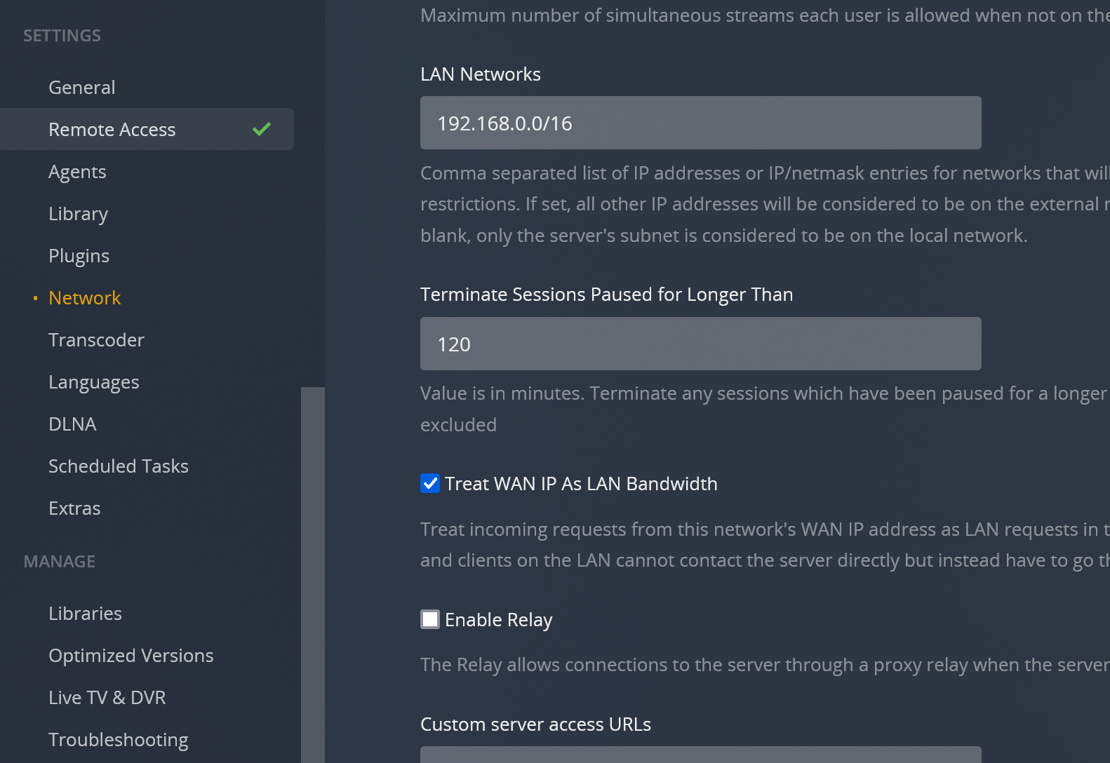

in the plex settings under network, you can tell plex what the local networks are, just in case its on a separate network or whatever.
"LAN Networks"
"LAN Networks"
thanks. I had already done this but it was the auto adjust function that finally fixed it for me.
indivision
Jan 4, 2013
806
"LAN Networks"
Odd. My install of Plex has very different settings in this section. How did this happen?
