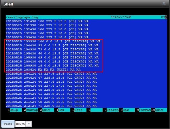

The nut log for the blackout event shows the following :
I simulated again a blackout by pulling the plug from the UPS and waited for the UPS to perform the shutdown. Strange enough, after the programmed time, the slave systems did shutdown properly but the FreeNAS server just sat idly without any message whatsoever (I was logged in with a SSH shell to monitor the shutdown message); the machine was not responsive and I had to shut it down by pressing the power button.
The log file for such an event was :

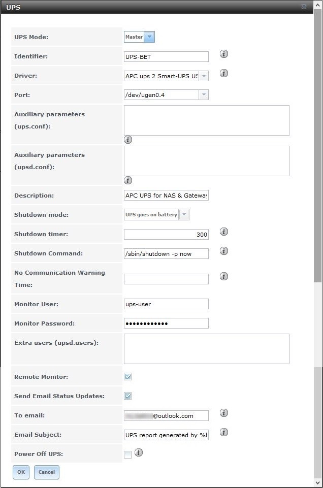

My nut setup is the following :

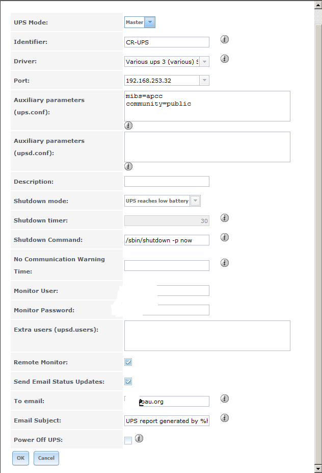

Is it possible that your battery discharges prior to the 300 second delay time expiring? If the slave servers shut down immediately on a power fail, perhaps you could decrease the delay time. I have an APC power chute appliance shut down the VM hosts. FreeNAS is configured to shutdown immediately on a low battery condition.
