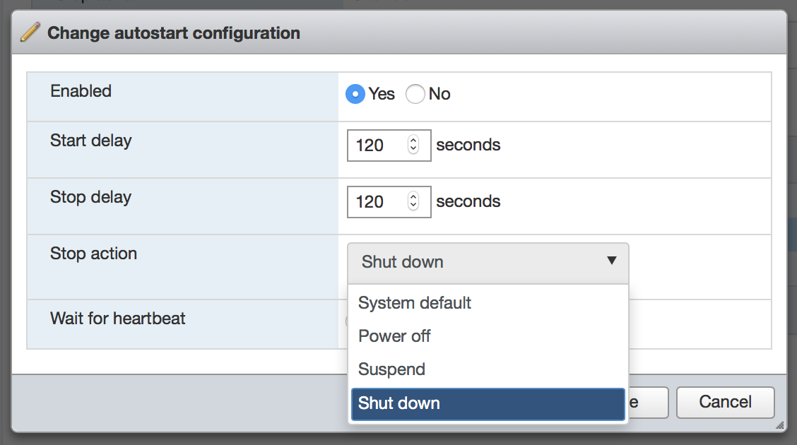

Thanks for your help! I've got it working! :)

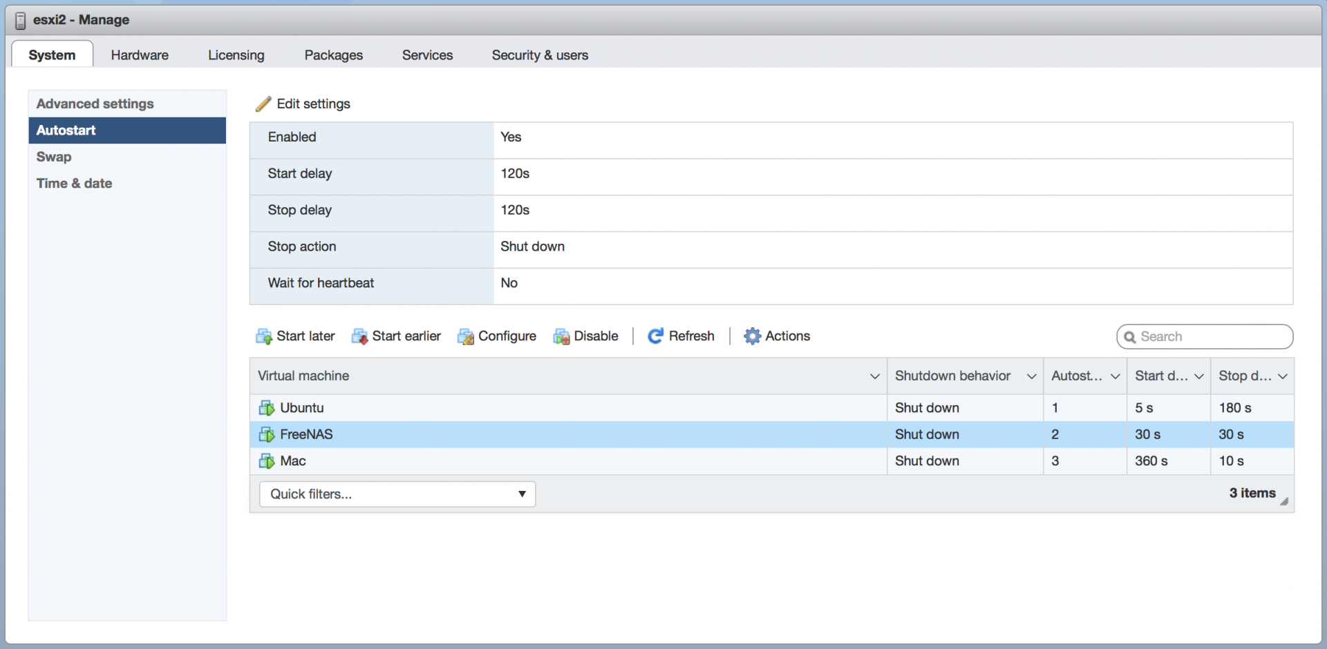

You were right, the autostart settings were the problem. The default Stop action in Host -> Manage -> System -> Autostart was "Power off" so I changed it to "Shut down" and now everything seems to be working correctly.
I also set the Autostart order so that my syslog server (Ubuntu) goes up first and down last so it can gather all the logs from other VMs.
