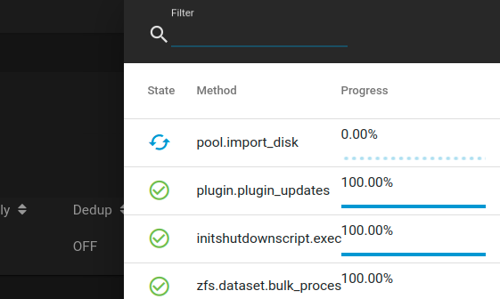

Hello everyone, just created a TrueNAS server and am importing the contents of an NTFS disk which contained my Windows backups (about 1.5TB). After an hour task manager shows progress as 0%.

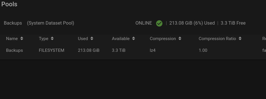

However, am seeing the used space in my pool continue to climb. I'm assuming I should ignore the task manager and that the import is proceeding properly?
