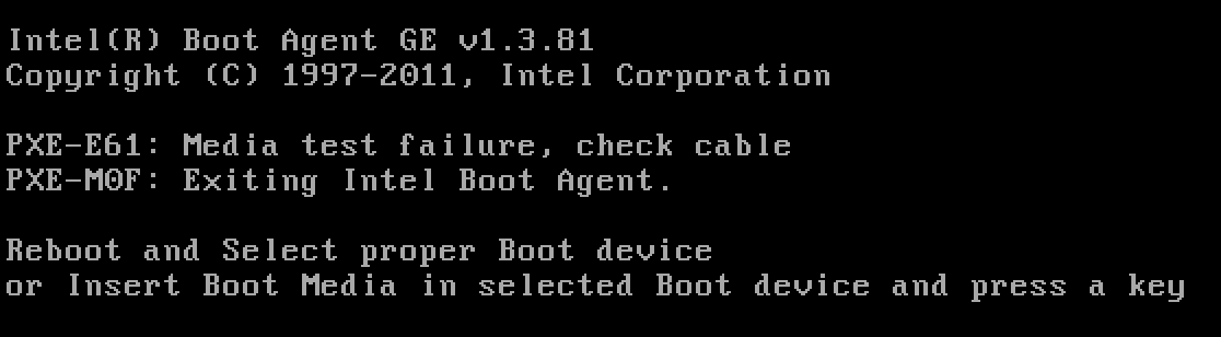

I just update to latest 9.10 and upon boot I get this (see attached).
it was booting perfectly from a pair of *mirrored* USBs...

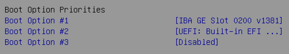

Either your boot drives are being bypassed for some reason (hardware failure, possibly) or the boot device priorities got completely hosed.
Your system is trying to boot to PXE, which has nothing to do with USB.
Check your boot priorities list, try swapping the two USB drives around, try removing one and then other...

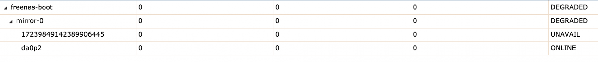

I took the main (the one on the mobo) out and still no boot.
I put the same usb in a secondary USB port and it now boots, but in degraded mode...

So I moved the USB from the secondary port (not the one that I move one post up) into the main (on mobo) port, and all seems to be fine now... ;)
