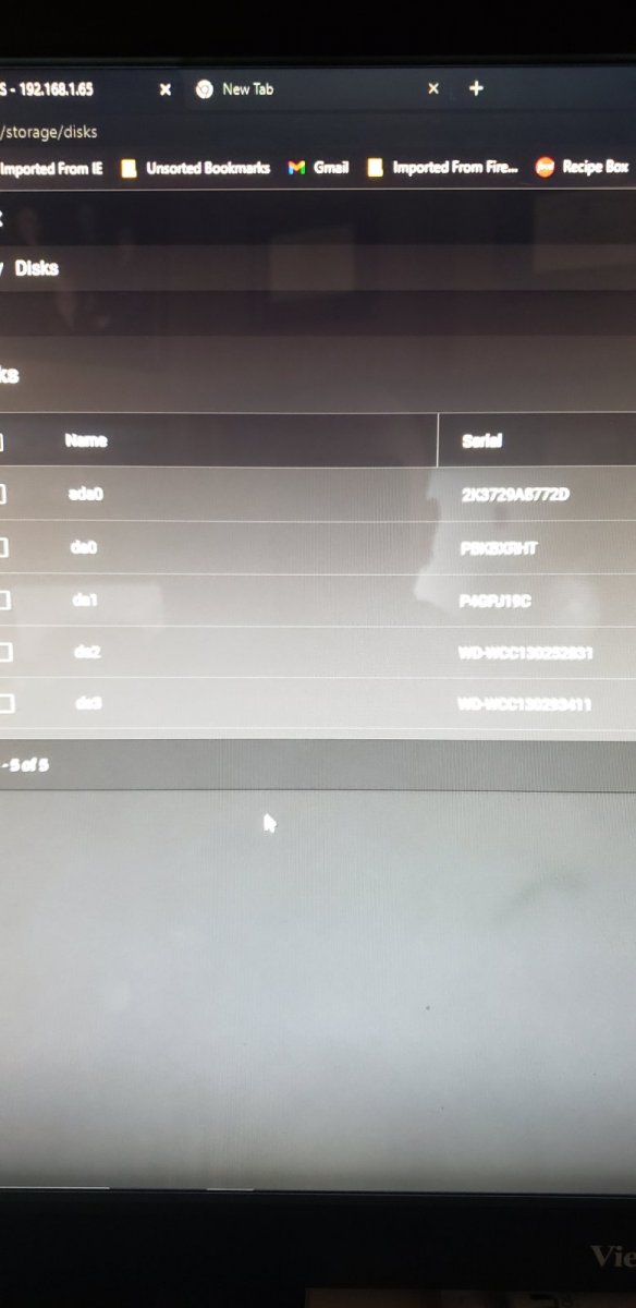

Hello all and hi.
This is my frist post in truenas community, and although i may be new here i have a bit of homelab experince and did my research before posting
I have a Dell PowerEdge R710 server that has 6 X 4TB hard drives 4 Hitachi's and 2 WD and i have also placed a SSD on the dvd tray and i am running truenas from a usb thumb drive. My hba card is one of these in a PCIe slot https://www.ebay.com/itm/123916887273 i pulled from a working HP nas that was runing unRAID
Here is my issue of the 6 drives attached to the backplane only 4 show up under Storage > Disks from place 0 to 3 even when i run "camcontrol devlist"

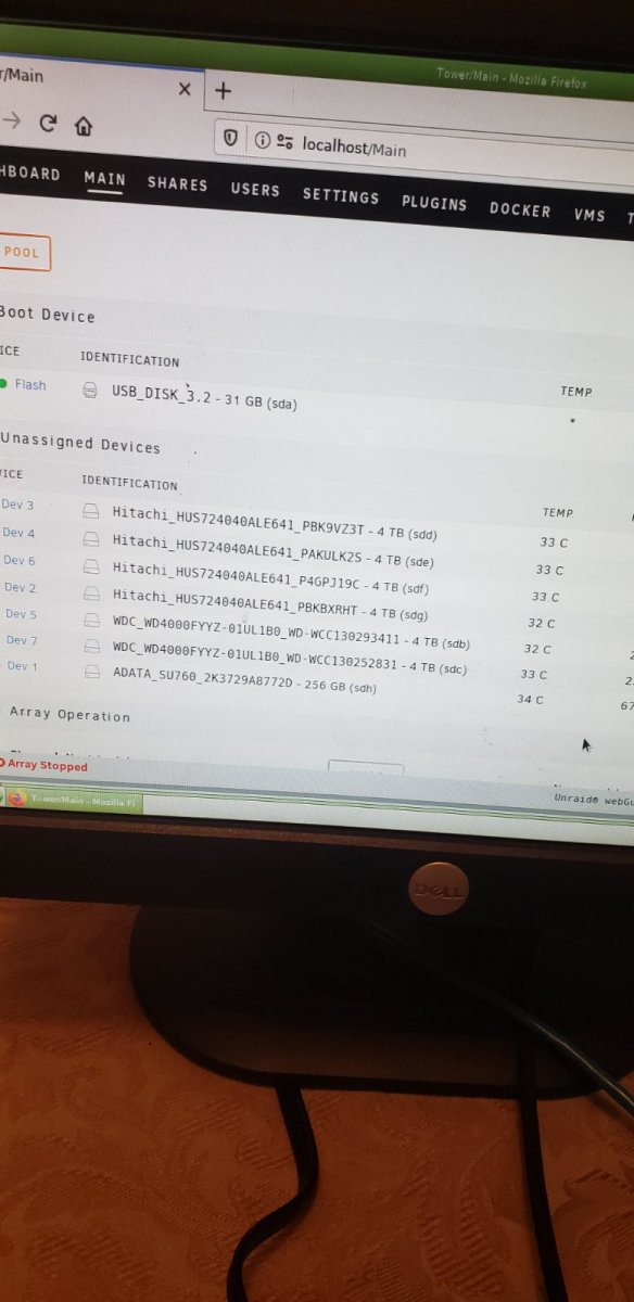

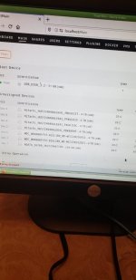

When the system boots i see all the 6 drives lined up under the LSI controller. Another test i did is that i booted form a unRAID USB and all 6 drives showed up under unraid os so i know the hba card works right and also the physical cable connnections
What can i do to get all the 6 drives to populate ? and what is causing this?
I am trying to use this just a simple back up server and i need all 6 drives!
Thank you in advance for your input
you can do a few things to try to understand what's happening...
camcontrol devlist should list all disks visible to the system
either dmesg | grep da or looking in more detail through dmesg | more could get you to any errors preventing disks from being presented to the OS.
also sas2flash -list might point us in the direction of a firmware upgrade being needed for the HBA

Also the other comands did not show any other dirves in their output i went through all of them line by line since i am having a hard time copying and pasting from the truenas instance and onto here.
I have read somewhere that someone downgraded to an older verson of trunas in order to get all his drives to show
Denis
9,703
Looks like there might be a version 20 (you're on version 10) of the firmware for that card. (not sure if the B1 vs B2 versions make a difference for the firmware... do your homework on that).
But here's a link to somebody else who was looking to upgrade their 2008 card.
you really see no other messages after a restart in dmesg that show that disks are being rejected?
