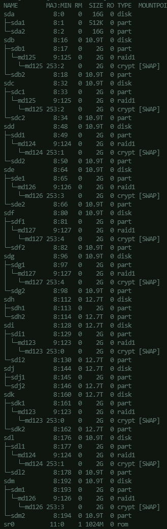

System was previously on core but I switched to scale some time last year. I was curious about the difference in amount of partitions per disk. These 12 disks are all part of a 3 vdev raidz1 pool. Thanks!

It's correct.
Each disk, when added to a new vdev, is partitioned into two devices.
The first (2G) is used for Linux "mdadm", as a member device of a raid1 "mirror". This mirror is then encrypted with dm-crypt and used as a swap device. (Nothing to do with ZFS.)
The second partition (remainder) is used as a vdev member, for mirror, RAIDZ1, RAIDZ2, or RAIDZ3. (This is ZFS.)

Gotcha. I guess I was wondering why some showed a crypt swap and 2 didn't (sdh and sdj). Thanks for the response btw.
Didn't catch that. Not sure why.
Did you disable swap creation at any point in time in your TrueNAS settings?
I know there was a bug not too long ago with SCALE in which partitions were created in the incorrect order/size, which had to do with TrueNAS's automatic swap space creation. This could be a spillover bug from that.

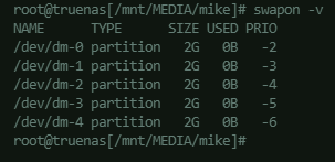

What does swapon -v reveal?

So my uneducated guess is there's probably a built-in limit to how much swap / how many swap devices will be activated on SCALE. Maybe that number is 5?
Someone like @Kris Moore might know.
