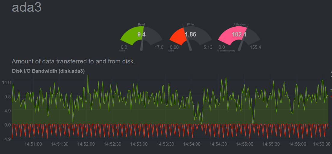

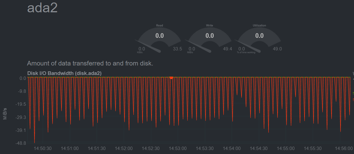

I am copying 2 TB of data from one disk to another (rsync job not attached to console).
They are both 5400 rpm SATA SMR devices.
I see a transfer speed of approximately 10 MiBps. Is this normal?
The server is not doing much else (CPU 2-3%). 16Gb RAM, core i3-9100.
It's a mix of 1K and 1-2M files.
9,703
Perfectly normal for high numbers of small files.
Lots of "wasted" time dealing with metadata, not a lot of time moving the actual data.
What model hard drives are you using?
These are just two single drives, not a pool of drives, right?
9,703
SMR drives are also a plausible reason for poor sustained writes. Most importantly, you shouldn't be using SMR drives with ZFS.
I had somehow missed that point... indeed this may explain extreme slowness in large data transfer.
Please have a look at dmesg to see if your disks are struggling (but generally look at replacing them with CMR).
