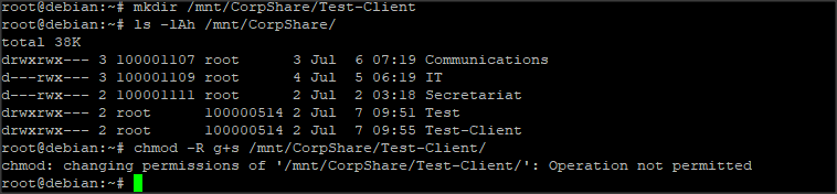

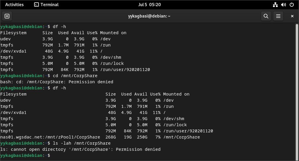

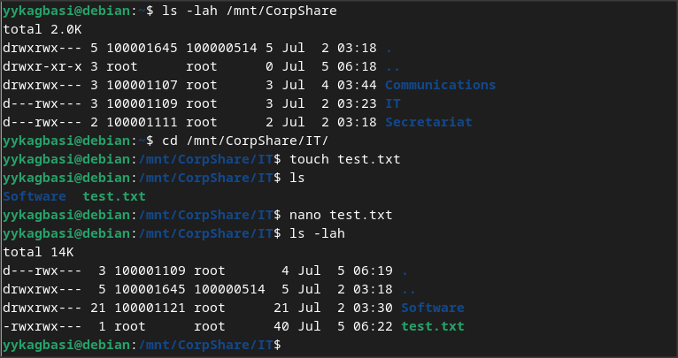

I can successfully mount the NFS Share from a Linux client (Debian 12 both manually and using AutoFS), however, when I attempt to change into the directory or run the "ls" command against it, I get "Permission denied" (see screenshot below). The client is bound to my Active Directory domain and I'm seeing this issue while logged in with the local root account and with a domain account. TrueNAS is bound to the same Active Directory domain.

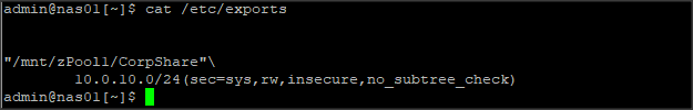

I have not applied any settings in the ADVANCED OPTIONS for the NFS Share (as confirmed by the exports below) - although, I'd experimented with different combinations of Maproot User, Maproot Group, Mapall User, and Mapall Group - all of which didn't alleviate my permission denied problem:

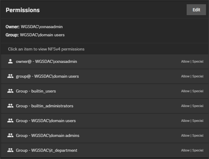

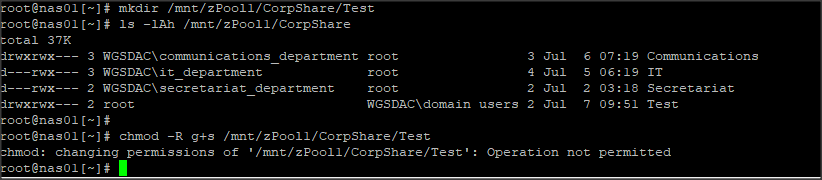

On the ZFS Dataset itself, I initially had permissions set to root as both Owner and Group. However, as part of my troubleshooting attempts, I changed Owner to the Service Account I'd created in Active Directory and set the Group to Domain Users.
