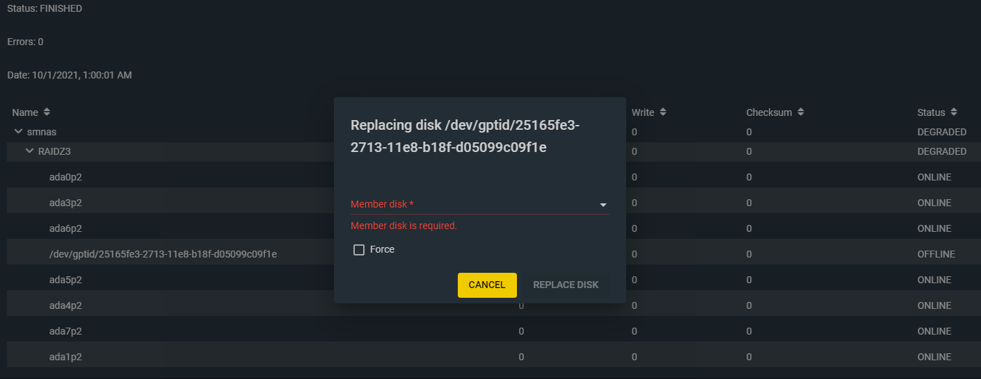

Have 8 x 6TB WD Red drives in a pool using v11.35-U5. Drive ada3 developed an unreadable sector.
I followed the manual and put the drive Offline then shut down system. Replaced drive with a new one and turned on system. I chose Replace for the drive but in the pop-up window there is no choice under "Member Drive".
I see that another drive is now called ada3 and the only free drive designator is ada2. Can that be the issue? Or do I just choose "force"?
I did search but the posts I saw with the same problem didn't put the drive offline before swapping. The closest post I saw is this one but at least he had the option of another drive under Member Drive where I have no choices: https://www.truenas.com/community/t...ly-can-replace-the-wrong-dev-da-number.77538/

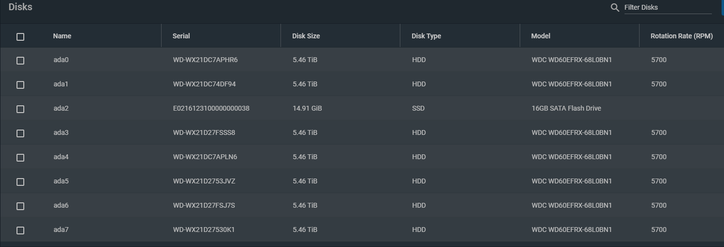

Actually, the new drive doesn't even show up under Storage>Disks. I thought ada2 was free but it's actually the SSD that came with the unit (IX Systems mini XL). See attachment.
I looked in the manual about renaming drives but can't find anything. Not sure if the SSD is supposed to be ada2 or if it really matters. I guess the next drive would be ada8 but I can't enter it manually into the "member disk" option.

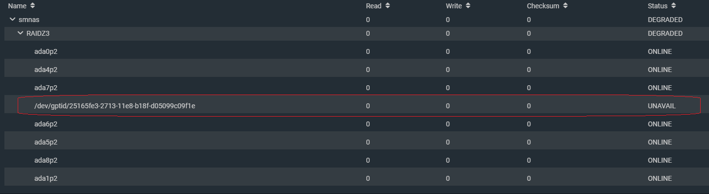

I tried something hoping it would work but didn't.
I installed the old drive and put it online and I was back to normal. I then put it offline and hot-swapped the replacement drive in hoping that without a reboot the drive naming would not change. But when I select replace, I still have no choices for selecting a drive. I selected the force checkbox but "confirm" is greyed out. I can put the drive online ok but it shows the the drive as unavailable and I still can't choose replace.
If I go to Storage>Disks, the drive doesn't show up and there isn't an ada3 (which is what the old drive was). Went to Import Disk but no disks are available in the drop down menu.
Is there a way to make it available?

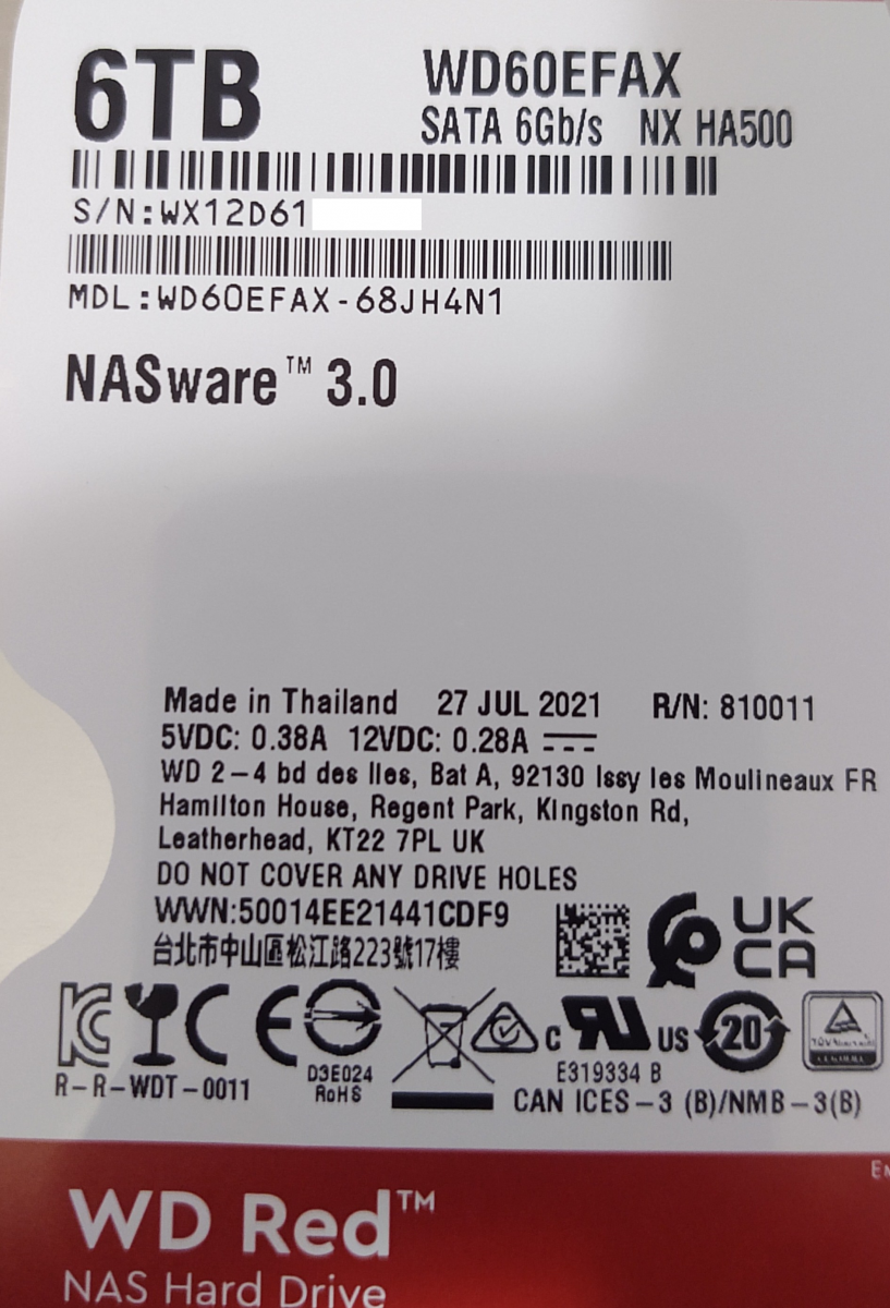

I'm beginning to suspect maybe the new drive I got from WD is bad. I just ordered it last week direct from WD. Is there a way to test it? I can try to format it with a Windows machine but not sure if that's a good idea or not. Not sure how to do it under FreeNAS if the drive is unavailable.
Attached image of new drive label.
Thanks for your time.
Samuel Tai
Apr 24, 2020
5,399
Yes, you got a SMR drive WD60EFAX, which has bad behavior with ZFS. You should get that swapped for a CMR drive WD60EFRX.

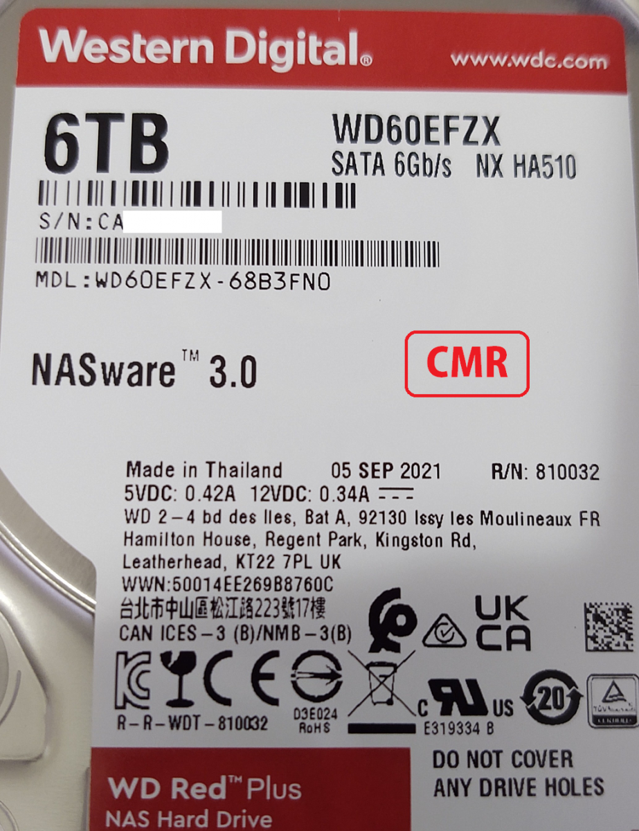

Interesting. I'm sending this drive back. It seems like the WD60EFRX that you recommend is discontinued and the ones that are available are very expensive.
What about the WD60EFZX which is listed as CMR on this datasheet and appears to be the replacement model for the EFRX.
Samuel Tai
Apr 24, 2020
5,399
The EFZX is OK.
shimon
Jul 23, 2016
16
Thanks for the assistance, Samuel.
When I get the new drive I'll update this post with the results.
shimon
Jul 23, 2016
16
I received the new drive today and the swap was fast and easy per the manual. Drive is currently re-silvering. Thanks again for the help.
