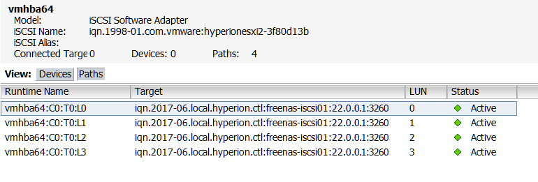

So I just started my FreeNAS box over from scratch after Corral...and now my iSCSI won't connect to VMWare. It connects fine to Windows, but in VMWare I see this for paths:

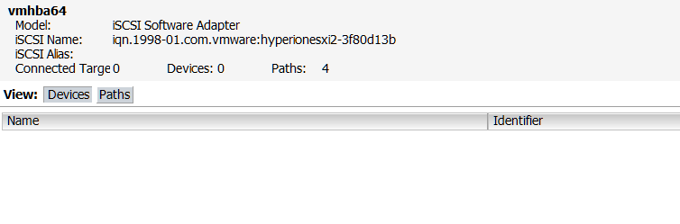

And devices:
e

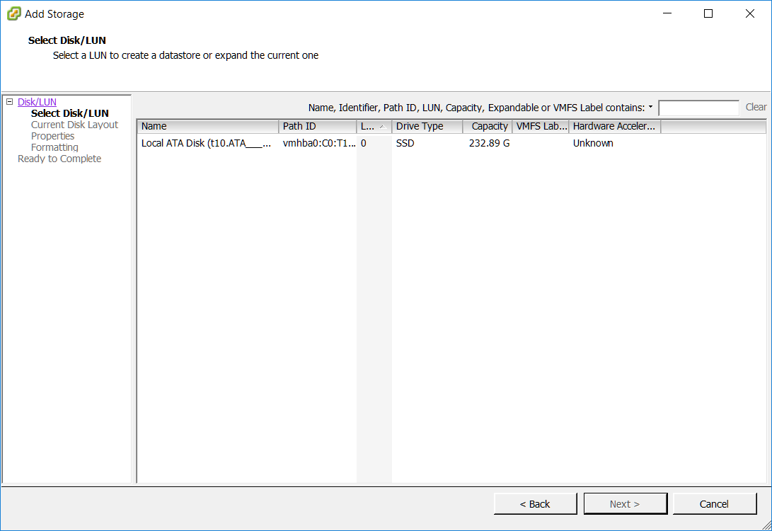

And when I try to add storage:

I re-created everything but the volumes from scratch. I created a new zvol all four iSCSI shares that you see in the paths above.

I figured it out! ESXi did not at all like a 4096 allocation unit. I switched it to 512 and they magically appeared. I'm sure this is documented somewhere. I happened across a random thread on the VMware community forums that clued be in! I guess I can go back to 11...but I'll wait until I finish my testing.
