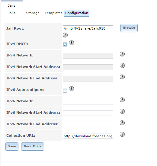

I'm not sure if this would help, but I had a problem with my 9.10. I have DHCP enabled on the jails configuration:

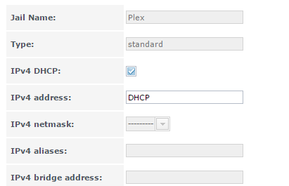

and also on the specific jail:

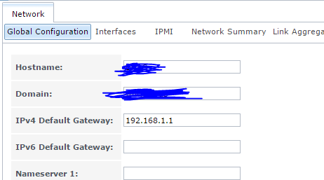

I also wouldn't get an IP address, until i set my default gateway under network
This is something new, I didn't have to do this under 9.3 or 9.3.1.

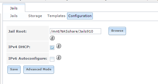

I'm super new to this, so bare with me. But I'm not specifying any IP address ranges anywhere in FreeNAS. I thought the DHCP option in the Jails -> Configuration meant "I'm using a DHCP server use IT to get an IP address, don't try to create IPs on the server (freeNAS jails)". Again, on my FreeNAS Jails -> configuration I have DHCP enabled, if I click advanced options the 'range' is grayed out. (adding screenshot)
Which leads me to believe that FreeNAS will not try to 'create' IPs, instead it'll use the DHCP on my router (which is also my default gateway). Then inside the jail itself for PLEX, I also have DHCP enabled, which I believe requests an ip from the "jails manager" (if I can call it that).
So to recap, this is how I understand it.
The Plex jail == DHCP enabled, which then it goes to it's parent the 'all jails' config, in my case, also DHCP, which then goes to the network and says 'gimmie an ip'.
